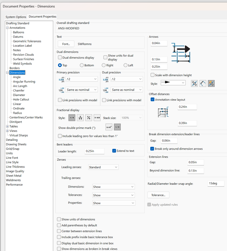

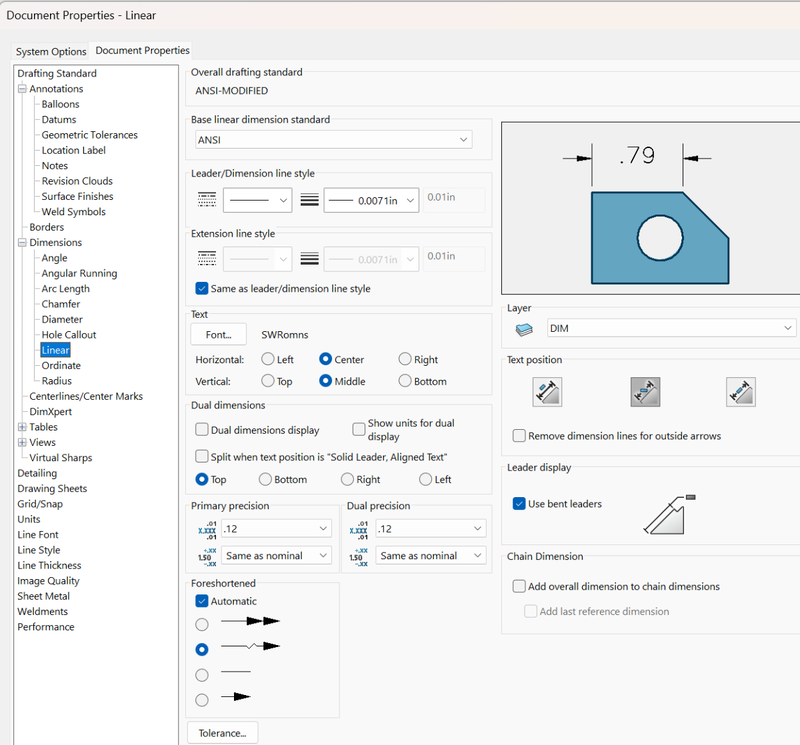

ILoveMadoka Posted August 29, 2024 Posted August 29, 2024 Solidworks 2023 How can I show inch marks after a decimal dimension? these are "hand-jammed" The closest I could figure out without having to manually change every dimension gave me this Is this possible? Help please.. Quote

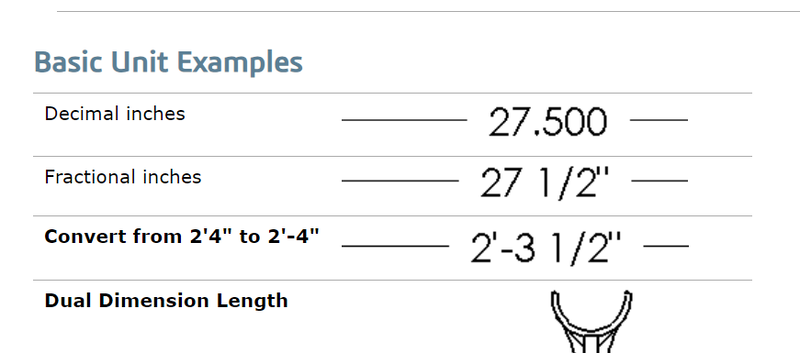

ILoveMadoka Posted August 29, 2024 Author Posted August 29, 2024 (edited) In the help file here I came across this I cannot find this in my settings anywhere... ps: I want the " after the DECIMAL dimension (24.25") Edited August 29, 2024 by ILoveMadoka Quote

ILoveMadoka Posted August 30, 2024 Author Posted August 30, 2024 I've looked all through my settings but cannot figure out how to create a dimension style in Solidworks. I can get fractions to display with the inch mark but not decimal dimensions. I appreciate your assistance Sir... Quote
SLW210 Posted August 30, 2024 Posted August 30, 2024 I do not think it's possible IIRC. Technically you don't put the " on decimal inches. If you look at the ASME and GD&T books, they don't use them on fractional either, more of an architectural and civil thing as far as I know. AutoCAD and IIRC Inventor lets you add them. Did you try the options when you click on a dimension? Quote

SLW210 Posted September 3, 2024 Posted September 3, 2024 AutoCAD is pretty useful for custom solutions, particularly if you know basic toolbar buttons, menus, LISP et. al. Most people like the look of manual drafting and AutoCAD easily adapts to what you are used to. Other software not so much. I worked more on ProE drawings to make them look like what we had from manual drafting days and our AutoCAD drawings and per request from the client (that insisted on ProE) than I care to think about. IIRC, it's been a long time since I used Soldworks, but select all dimensions and add " and save as favorites. There may be some MACROs available on the DSS forums Login | 3DEXPERIENCE ID | Dassault Systèmes (3ds.com). As long as I worked with Solidworks, it has been asked. Quote

mhupp Posted October 28, 2025 Posted October 28, 2025 100% agree. I'd take BIGAL's route but idk if it would suffer from the same issue as my first screenshot. but the macro could be used to update old drawings easily. Coming from cad one of my main grips about solidworks was the customization and how you had to go digging around menus to change things. But I inderstand why it's that way. Did see if you had a dimension selected in the option panel you could go to other tab > override > feet inch and it would use like 3' - 6“ but if it was less than 12" it would only use in. Our drawings only show the number and just have a note in the title block saying. all dimensions are in inches unless otherwise called out. We have some Europe contracts so we will have to do things in metric from time to time. 1 Quote
