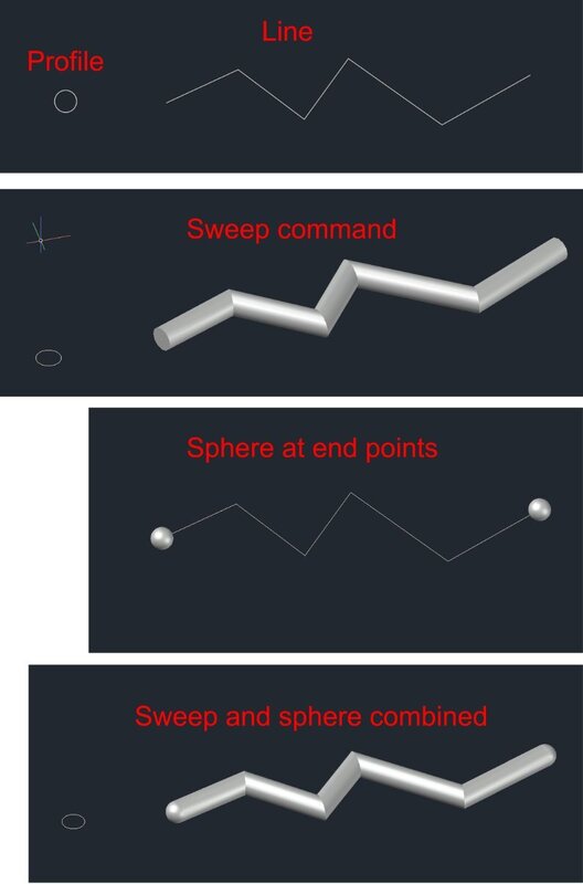

I have two lisp routines and both work great separately. I am trying to combine them into just one working routine.  I don't think I am passing the right information from the first routine into the second because only the first half works. Second half fails.
Routine desired: User selects a circle profile and then selects a group of entities (lines, arcs..etc). A sweep command is done on the entities and then a sphere of the same size as the profile selected is added to the end points.

I am attempting to combine both routines into one. Its not working unfortunately. I believe I am not passing the correct information of the size of the profile selected to the second part of the routine for the sphere size. I tried to get the real number of the circle profile for the sphere size but maybe that's where it is failing...I don't know...

Try this expects say a profile as you suggested a circle already exists.

Another one...

Sorry for the late reply. Yes, both solutions worked great! Thank you guys for the help...🙂
