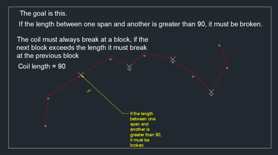

I have a function that draws a polyline along the shortest path through a series of points. I've managed to modify it to break the polyline when it reaches the maximum bobbin length. However, I need help refining the function so that when the maximum length is reached, it segments the polyline at the nearest block point within the point list (plist). Additionally, if the gap between points in plist is greater than the bobbin length, the function should add a new segment without aligning exactly with a plist point. How can I perform this check and adjustment efficiently?

@BIGALThank you for your feedback. Let me try to explain better, as it may not have been clear before.
Currently, your code is generating results in a way that doesn't seem to make much sense:
My code is segmenting at the correct length, however it does not follow the desired split points, so it does not align the break directly over the block.
The goal is this:
If the length between two spans exceeds the length of the coil, it must be segmented. The coil must always end in a block. If the next block exceeds the length limit, it must break at the previous block.
I've tried several codes, but I still haven't been able to implement this check correctly. Thanks in advance for your help!
