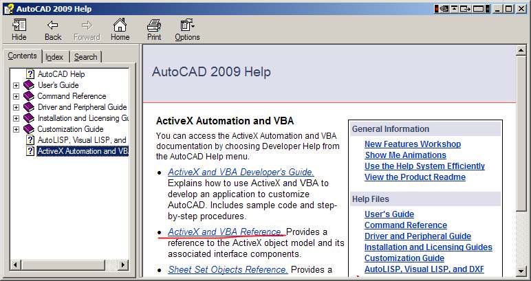

Hi,
I use Cad 2008 and in the help I can't find somting like "setXdata" or somting simuler.
You first have to get to the "ActiveX Automation and VBA" section from help.
Hi,
Which help do you use?? The 1 in VBA or in CAD.
Anything specific to AutoCAD can only be found in AutoCADs Help section as shown above.
