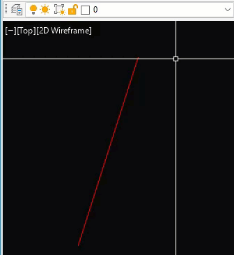

For my code below the first section for preselected entities works as intended, but using ssget in the second section requires the user to confirm the selection.
I'd like the user to:
  1. Run the command
  2. Select the entity
  3. Have layer of the selected entity be set to current without confirmation
Any ideas?
thanks in advance

If you have PICKFIRST set to 1 you should not have to check for an implied selection.
Maybe this?
(defun c:foo (/ s)
  (if (setq s (ssget))
    (setvar 'clayer (cdr (assoc 8 (entget (ssname s 0)))))

i think you confused the intention behind my script but gave me direction on 'clayer vs _.layer. modified the second portion of my code accordingly and it works. strange enough i do have pickfirst set to 1, but still needed to delineate out the options in my code
Thanks!

Check my post above again .. I had initially misread what you were trying to do and fixed it but not before you read the old one 😂
hah! guess i was too quick...it works as intended, except i still have to confirm selection for objects i don't pre-select
Weird. I cannot replicate that on my system.

If you only want to set the layer then why not use what is inbuilt. There should be a command version so could shortcut it, lll.
Maybe laymcur.

Try this .. it forces single object selection :)
(defun c:foo (/ s)
  (if (setq s (ssget "_:S"))
