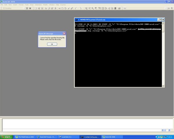

Guest LElkins Posted December 19, 2007 Posted December 19, 2007 ok, memphis, read this very carefully and if you are unsure of anything then please ask. try what i describe below with example files first. create a new drawing and create blocks in it called new_test and save it in C:\ then wblock some linework and save it in C:\cad_file\new_block.dwg open notepad and copy the code below and save as blockreplace.scr -layer n newblocklayer s newblocklayer -insert C:\cad_files\new_block 0,0 1 1 0 -blockreplace new_test new_block y layerp -laydel n newblocklayer y qsave quit when you have tried this and happy that it works and want to use it on your project drawings, in the code above, replace C:\cad_files\new_block with the path of your new block. For some reason i can not get it to work with space in file name so replace all spaces with underscore, this includes folder names. replace new_test with the name of the existing block which will be replaced. open a new notepad and copy the code below and save it to a file called block_replace.bat FOR %%V IN (*.DWG) DO START /W "c" "C:\Program Files\AutoCAD Architecture 2008\acad.exe" %%V /nologo /b "C:\blockreplace.scr" FOR %%V IN (*.BAK) DO DEL %%V In this, replace the AutoCAD Architecture 2008 with the version that you are using. Put both block_replace.bat and blockreplace.scr in C:\ and also put your drawings there. when running the routine you will not be able to use your machine so will be best to run over luch. to run the routine just double-click on block_replace.bat hope this helps. if any of this is unclear then please just ask and i will be more than happy to help. cheers Quote

memphis710 Posted January 3, 2008 Author Posted January 3, 2008 LElkins, cheers for the script. Got it to run standalone with the correct files. However, I cant get the batch script to run properly. It loads up acad, and the first drawing file, but acad loads with the error pictured. It says it cant find the old block, (I have checked the name of the block and it is right) and skips on to the next line in the script, still searching for a valid block. Is this due to the incorrect drawing loading in the first instance? txt file is acad command output. Cheers so far, great help. Error.txt Quote
