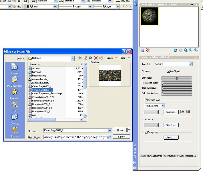

shift1313 Posted April 13, 2009 Share Posted April 13, 2009 as far as i know this site doesnt have a material library. Did you follow a link to some other site? Can you get to your materials tab window or is that the issue? I have 07 and 09 but dont have 08. I know the layout of 08 was similar to 07 Once you ahve your material window open you will create a new material using one of the templates in the material editor(Realistic,advanced metal...) Below that you will have a few boxes for Diffuse map, bump map, opacity map. There is a select button and this is where you will link to your jpeg. The sphere(or whatever mapping shape you choose) will show your material like in the screen shot. Quote Link to comment Share on other sites More sharing options...
