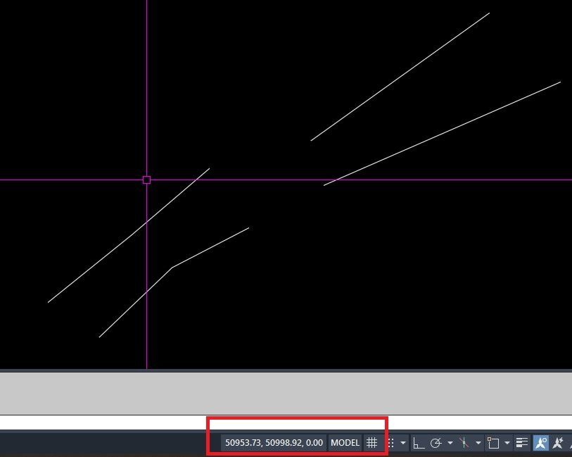

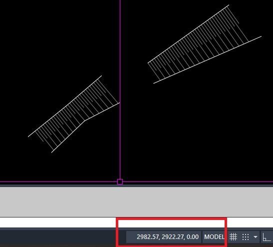

DraganK Posted December 13, 2024 Posted December 13, 2024 (edited) Hello, I need help. I use the lisp Batter to draw slope tick lines and the lisp works great if my drawings are in coordinates that have 3 or 4 digits. Example (100.00,200.00) or (5100.00, 5100.00) but the coordinate system that uses UTM zone 34 has 9 and 7 digits (34455000.00, 4951000.00) simply the lisp does all the operations but does not draw the slope lines. If I move the entire drawing to coordinates with 3 or 4 digits the lisp works great, I noticed that if the drawing is in coordinates with 5 or more digits the lisp does not draw tick line. My knowledge of auto lisp is very little so if someone can help me and correct the codes in lisp I would be very grateful. sorry for my bad English (defun c:batter () (setq oldlay (getvar "clayer")) (setvar "osmode" 0) (command "-view" "s" "cur") (command "ucs" "w") (if (not (tblsearch "layer" "BATTER")) (command "_.layer" "_make" "BATTER" "_color" "8" "" "") ) (setvar "clayer" "BATTER") (setvar "cmdecho" 0) (setvar "aunits" 0) (setvar "angbase" (/ pi 2)) (setvar "angdir" 1) (if (not lint) (setq lint 10.0)) (setq int (getdist (strcat "\nInterval <" (rtos lint 2 3) ">: "))) (if int (setq lint int) (setq int lint)) (command "line" (list 0.0 0.0) (list 0.0 0.0001) "") (if (tblsearch "block" "tadtick") (command "block" "tadtick" "y" (list 0.0 0.0) (entlast) "") (command "block" "tadtick" (list 0.0 0.0) (entlast) "") ) (while (setq refent (entsel "\nSelect reference line: ")) (command "undo" "group") (redraw (car refent) 3) (initget 1 "Cut Fill") (setq reply (getkword "\n[C]ut or [F]ill batter: ")) (setq s (ssget)) (command "measure" refent "b" "tadtick" "y" int) (setq p (ssget "p") cn 0) (if s (progn (while (< cn (sslength p)) (setq en (entget (ssname p cn)) p0 (cdr (assoc 10 en)) pt1 p0 pt2 nil b (cdr (assoc 50 en))) (entdel (ssname p cn)) (setq p1 (polar p0 (+ (/ pi 2) b) 0.0001)) (command "line" p0 p1 "") (command "extend" s "" (list (entlast) p1) "") (setq xent (entget (entlast))) (setq xdist (distance (cdr (assoc 10 xent)) (cdr (assoc 11 xent)))) (if (not (equal xdist 0.0001 0.0001)) (setq pt2 (cdr (assoc 11 xent))) (progn (command "extend" s "" (list (entlast) p0) "") (setq xent (entget (entlast))) (setq xdist (distance (cdr (assoc 10 xent)) (cdr (assoc 11 xent)))) (if (not (equal xdist 0.0001 0.0001)) (setq pt2 (cdr (assoc 10 xent))) ) ) ) (entdel (entlast)) (if pt2 (if (= reply "Fill") (if (= (rem cn 2) 0) (command "line" pt1 pt2 "") (command "line" pt1 (polar pt1 (angle pt1 pt2) (/ (distance pt1 pt2) 2)) "") ) (if (= (rem cn 2) 0) (command "line" pt2 pt1 "") (command "line" pt2 (polar pt2 (angle pt2 pt1) (/ (distance pt2 pt1) 2)) "") ) ) ) (setq cn (1+ cn)) ) ) ) (command "undo" "en") ) (setvar "clayer" oldlay) (command "-view" "r" "cur") (command "-view" "d" "cur") (princ) ) (prompt "\nDraw cut/fill batter slope lines.") batter.lsp Edited December 13, 2024 by SLW210 Added Code Tags! Quote

DraganK Posted February 28, 2025 Author Posted February 28, 2025 6 minutes ago, GLAVCVS said: Does your drawing contain blocks? The drawing has no blocks, the drawings I posted only have 4 lines between which I draw slopes. In the drawing where the coordinates have 4 digits the lisp works but in the other drawing with 9 and 7 digits it does not work. Sorry for my bad English Quote

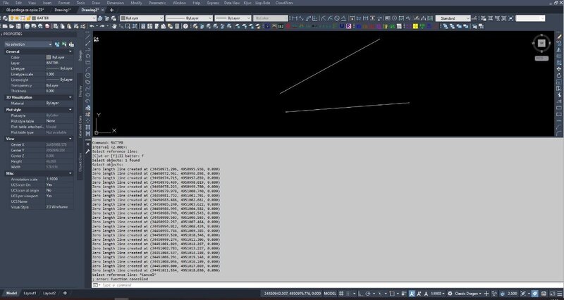

DraganK Posted March 3, 2025 Author Posted March 3, 2025 Dear friends, thank you for your help and testing Lisp. Today I tried to draw slopes in one drawing in two places, the first place is a line with 4-digit coordinates and it works great, and the second place is a line with 9-digit coordinates and it does not draw slopes. So I believe that the problem with my Civil 3D 2023 is in some setting. Thanks again for testing. Quote
GLAVCVS Posted March 3, 2025 Posted March 3, 2025 28 minutes ago, DraganK said: Dear friends, thank you for your help and testing Lisp. Today I tried to draw slopes in one drawing in two places, the first place is a line with 4-digit coordinates and it works great, and the second place is a line with 9-digit coordinates and it does not draw slopes. So I believe that the problem with my Civil 3D 2023 is in some setting. Thanks again for testing. Try this: I've modified the previous code I tried to display a message if there is no selection set. Copy the code again and test it. If it doesn't display an alert with the message 'Without Sset' try something else: do a 'zoom extents' to make sure the code didn't draw the lines too far away. Did I explain myself correctly? Quote
