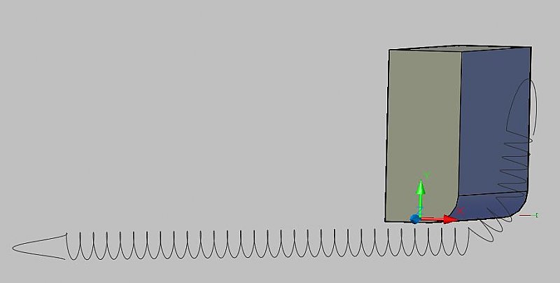

TheNewGuy Posted April 14, 2009 Posted April 14, 2009 OK I got a tough one. Is there a simple way to "bend" this spring so that is does not project through the 3d square? I am trying to replicate the way that it actually looks in real life. I tried stretching and that did not work. I could attempt to create several pieces of helix at different vertical growth settings then put them together, but that would be labor intensive. Is there a simpler way? It seems like there should be. spring question2.dwg Quote

shift1313 Posted April 14, 2009 Posted April 14, 2009 check out the showcase forum. fucarro has a post for a telephone corde which he created a helix along a spline path(i think). I didnt open your file yet but i guess this is what you are looking for. I do not know of any way to "stretch or bend" something that in acad. Inventor will dynamically model a spring but i still dont think you can bend it around an object, but ive never tried. Quote

shift1313 Posted April 14, 2009 Posted April 14, 2009 So i guess along the same topics, even though we are out of acad realm now, could you create a flat bar or cylinder that would act as the spring around the block? to the original poster. The spring you have modeled is just a helix and has no solid properties. If all you are looking for is a visual representation you can explode your helix and rotate part of it in relation to the rest like the picture i attached. really all its doing is moving part of the helix in relation to the rest. you will not be able to use this as a path for a sweep anymore. If you sweep a circle along that path first. slice it then create a second sweep to reconnect the spring at the bend you will get a 3d soild visual reference. Quote
TheNewGuy Posted April 14, 2009 Author Posted April 14, 2009 Ok that should work. I eliminated the extrude along a path for posting because of file size. In the model I am working on I have a 3D solid. I like your suggestion it is simple and should work. I feel like I should have thought of that! I have not used the slice command yet so here goes...Thanks for your help! Quote
