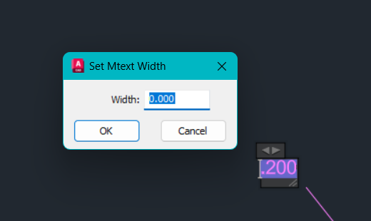

0misclose Posted January 22 Posted January 22 I have a drawing with multiple rotated dimensions and some are quite small resulting in text being offset to the leader. I was wondering if there is an easy way to change all the text box components of the dimensions to fit the actual size of the text so that it isn't so offset from the leader without exploding all the dimensions. I've included some snap shots below for reference. There are quite a few in the file so I want to try and avoid having to do them manually one by one. Any help would be greatly appreciated. Regards, Ryan Quote

0misclose Posted January 27 Author Posted January 27 Does anyone know of a way to set the mtext width to 0 for all the rotated dimensions in one go? Because that seems to be what I need. Quote
SanganakSakha Posted November 27 Posted November 27 (edited) I know its late by few months. May be, somebody in future will find it useful. I accidentally came across this post while browsing and found it interesting. So, I decided to have a go at it. After spending about 10 hours over 2 days (I am little out of touch with AutoCAD currently) exploring various options, I came out with following AutoLISP code that does the job. It assumes that every dimension embeds exactly one and and only one Mtext object. (defun c:DimMTextWidSetZero () ;;;;; Sets fixed width of MText (embedded in dimensions) in all dims to 0. No user interaction requred. ;;;;; Disclaimer: No error-checking or validation is included. (vl-load-com) (setq reqdObjName "MTEXT") (setq dims (ssget "X" '((0 . "DIMENSION")))) ;;;; Create a selection set of all dims in the drawing. (setq kounter 0) (while (< kounter (sslength dims)) (setq enameDim (ssname dims kounter)) ;;;; Process the dims one by one (setq nameBlkDin (cdr (assoc 2 (entget enameDim)))) (setq eNameBlkDim (tblobjname "Block" nameBlkDin)) (setq reqdEnt (entnext eNameBlkDim)) (setq objName (cdr (assoc 0 (entget reqdEnt)))) (while (/= objName reqdObjName) (setq reqdEnt (entnext reqdEnt)) (setq objName (cdr (assoc 0 (entget reqdEnt)))) ) (if (= objName reqdObjName) ;;;;; If it is mtext (progn (setq objMtxt (vlax-ename->vla-object reqdEnt)) (vlax-put-property objMtxt 'Width 0) (vla-Update objMtxt) (vla-Update (vlax-ename->vla-object enameDim)) ) ) (setq kounter (1+ kounter)) ) ) A couple of interesting points: 1. Nobody mentioned about DimStyle used - Dowels. If you insert a new dimension using the same dimstyle, there are no spaces. In fact there is no access manually to the 'Fixed Width' of MText embedded in a dimension. 2. I could not manually create a similar dimension, So it seems that the problem has been created by translation or the fixed width of the MText is modified using code AFTER dimensions have been inserted. 3. There does not seem to be reliable / consistent method to manually modify the fixed width of the MText. I have attached the drawing file generated after running the code. Enjoy! dim_test_file_OUT.dwg Edited November 27 by SanganakSakha Quote

SanganakSakha Posted Wednesday at 08:45 AM Posted Wednesday at 08:45 AM Thanks EleenD03, glad you found it useful. Same logic could be leveraged for other object that internally contain MText. Quote
