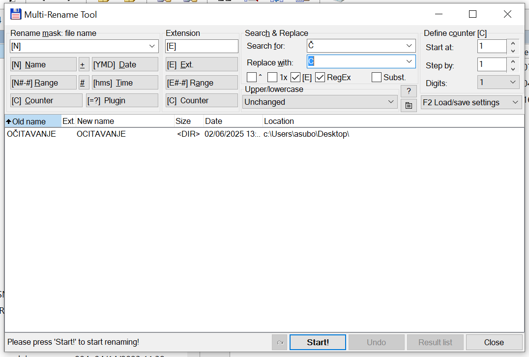

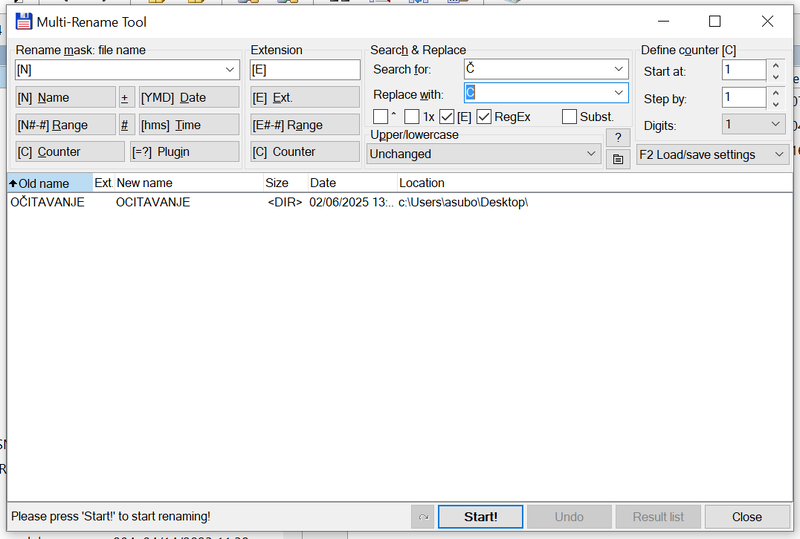

Saxlle Posted February 6, 2025 Posted February 6, 2025 I think there is no bulit-in function that can do that, except if someone develop the translator from unicodes to ascii. Otherwise, there is always solution for renaming, one of this is Total Commander, in card Files -> Multi - Rename Tool (picture 1). After replacing each letter (Ć, Č, Š, Đ, Ž, etc.) to (C, C, S, DJ, Z, etc.) it will run-over every folder or file and change it (click on Start!). Try it on small files or folders and see what is going to happen. (Probaj sa ovim, uvek odradi posao bez problema ) Quote
Tomislav Posted February 6, 2025 Author Posted February 6, 2025 thanx, hvala, i know about that program but will try to keep intact file names...found some leads to some lisps that translate but don't quite understand them Quote

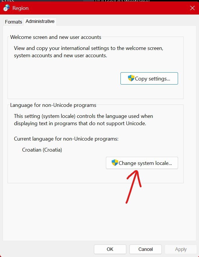

Tomislav Posted February 6, 2025 Author Posted February 6, 2025 found a solution!! for all of u that have same problem you go to Administrative language settings in Windows settings and under Change system locale u change it to your country Quote
Saxlle Posted February 6, 2025 Posted February 6, 2025 Yes, it does work when change it to desire language. Nice Quote
