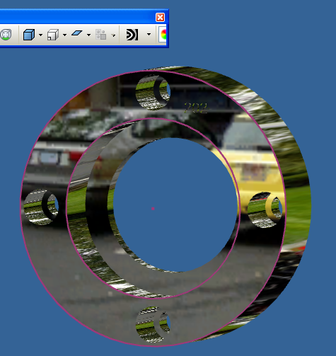

gbradley Posted April 20, 2009 Posted April 20, 2009 That's gorgeous. How do you get that Chrome finish? Quote
JD Mather Posted April 20, 2009 Posted April 20, 2009 That's gorgeous.How do you get that Chrome finish? There are several different Chrome finishes in Inventor. Upper right corner of screen. Quote
gbradley Posted April 20, 2009 Posted April 20, 2009 That's Cool I can see the Yellow Mini Cooper in the background. I couldn't see that pull down button in my tool bar for some reason. http://www.cadtutor.net/forum/attachment.php?attachmentid=11508&stc=1&d=1240255757 Quote
JD Mather Posted April 20, 2009 Posted April 20, 2009 If you don't like that Mini Cooper reflection go to Tools>Application Options>Color tab (Inventor 2009 and later) and change the Reflection Environment file name. Quote
gbradley Posted April 20, 2009 Posted April 20, 2009 Thanks, I am installing Inventor 2010 Suite right now, so the issue with only being able to see half of the pull-down button on the toolbar will probably go away. I kinda like the Mini, it gives the reflection realism. I have been using MDT in the past, but I am now trying to Learn Inventor, as time allows, because eventually MDT will no longer be supported. Quote
JD Mather Posted April 20, 2009 Posted April 20, 2009 ...so the issue with only being able to see half of the pull-down button on the toolbar will probably go away. Looks to me like a screen resolution problem 1024x768 is not enough. Quote
