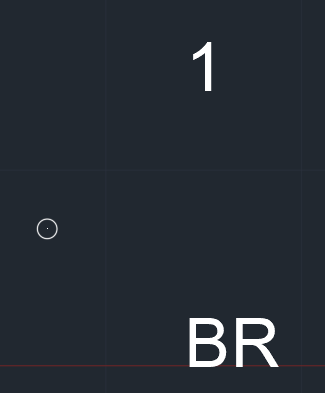

hello everyone, i need help with positioning attdefs, the problem is what ever i change they end up at ucs origin instead of at  supplied pt.
here is part of lisp that creates block if it doesn't exist and part that inserts it

only when i explode made block, attributes move from ucs to point position

Hey @Tomislav,
Maybe the best way is to calculate the "point position" according to "supplied pt" (I supposed it's from somewhere where the user pick a point to insert a block?). If it's so, then use this:
(setq pt_attdef_one (polar pt 0.785 10) ;; 0.785 is the angle of 45 degree, 10 is the length (you can change the angle and length)
      pt_attdef_second (polar pt 5.497 10) ;; 5.497 is the angle of 315 degree, 10 is the length (you can change the angle and length)
Then, you can change it in your code to look like this:

And you will get something like this from picture (I put a number "1" and "BR" just for the example):

the attributes should be right there next to point without calculating, that's why this (cons 10 ) is for...when defying attributes here is relative position to insertation point
in my other lisp this function works normally, but in this one it doesn't...

If values for 72 and 74 dxf codes supplied, you will get this (link): If group 72 and/or 74 values are nonzero, then the text insertion point values are ignored and new values are calculated by AutoCAD based on the text alignment point and the length of the text string itself (after applying the text style).
If you want to avoid this, than you can for the second attribut making according to insertation point (pt) do this "(cons 10 (cons 10 (list (car pt) (- (cadr pt) 0.3) (caddr pt)))" (where 0.3 is the text height), and you will get something like this and need to put (cons 74 0) in all attribut definition:
If (cons 74 0) are non-zero value, I get this:
Also, you can change (cons 70 0) to be visible, otherwise the values are not appears to be visible in drawing.
yes, that solves it, thank you!👍
didn't read that anywhere about omitting 72 and 74 ...
now i'm really puzzled why my other lisp (second one submitted) works and first doesn't and they both have same 72 and 74 non zero values???

I think if both values nonzero 72 2 and 74 3, or 72 for e.g 1 and 74 0, or 72 for e.g 0 and 74 1, the text insertion point values are ignored.
