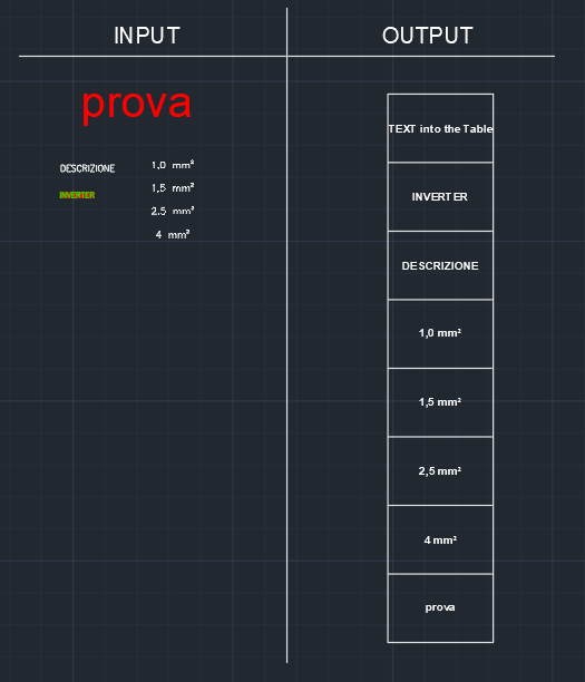

itacad Posted March 28, 2025 Posted March 28, 2025 Hello, I ask you if there is a way or do you know a lisp, that starting from a series of texts and multiline texts selected, generates an autocad table. Thanks Quote
BIGAL Posted March 28, 2025 Posted March 28, 2025 (edited) There are a few examples out there that do what you want, but to comment properly need a dwg to look at. There is some hiccups at times like missing text in a row. Edited March 28, 2025 by BIGAL Quote
itacad Posted March 31, 2025 Author Posted March 31, 2025 Ok, I attach a simple file of a group of texts with different characteristics Transform selected texts into a table.dwg Quote
Saxlle Posted March 31, 2025 Posted March 31, 2025 Hi @itacad, Try with this: ; ************************************************************************************* ; Functions : SX:addTableInMS ; Subfunctions : - ; Description : Put the TEXT or MTEXT values into the tabel in model space ; Author : SAXLLE ; Date : March 31, 2025 ; ************************************************************************************* (prompt "\nTo run a LISP type: SX:addTableInMS") (princ) (defun c:SX:addTableInMS ( / ss len i text_list text_val n acadObj doc pt numRows numColumns rowHeight colWidth txtHeight row col str_header modelSpace myTable) (setq ss (ssget '((0 . "*TEXT"))) len (sslength ss) i 0 text_list (list) ) (while (< i len) (setq text_val (cdr (assoc 1 (entget (ssname ss i))))) ;;; (if (equal (cdr (assoc 0 (entget (ssname ss i)))) "TEXT") ;;; (setq text_val_new (LM:UnFormat nil text_val)) ;;; (setq text_val_new (LM:UnFormat T text_val)) ;;; ) (setq text_list (cons text_val text_list)) (setq i (1+ i)) ) (setq colWidth (strlen (nth 0 text_list))) (repeat (setq n (length text_list)) (setq n (1- n)) (if (< colWidth (strlen (nth n text_list))) (setq colWidth (strlen (nth n text_list))) (setq colWidth colWidth) ) ) (setq acadObj (vlax-get-acad-object) doc (vla-get-ActiveDocument acadObj) ) (if (= 1 (getvar 'cvport)) (setvar 'ctab "MODEL") ) (setq pt (vlax-3d-point (getpoint "\nPick the insertation point for Table:")) numRows (+ (length text_list) 1) numColumns (getint "\nEnter the number of columns:") rowHeight 3.00 ;;; colWidth 10.0 txtHeight 2.50 row 0 col 0 str_header "TEXT into the Table" ) (setq modelSpace (vla-get-ModelSpace doc)) ;;Add a Header to Table (setq myTable (vla-Addtable modelSpace pt numRows numColumns rowHeight (* colWidth 3))) (vla-SetTextHeight2 myTable row col row txtHeight) (vla-SetColumnWidth myTable col (* colWidth 3)) (vla-SetText myTable row col str_header) ;; Iterate trought the "text_list" and add a value to every row ;; Outer while start (while (< col numColumns) ;; Iner while start (while (< row (length text_list)) ;; start if (if (<= (1+ row) (length text_list)) ;; progn start (progn (vla-SetTextHeight2 myTable (1+ row) col (1+ row) txtHeight) (vla-SetCellAlignment myTable (1+ row) col acMiddleCenter) (vla-SetText myTable (1+ row) col (nth row text_list)) ) ;; progn end ) ;; if end (setq row (1+ row)) ) ;; end iner while (setq row 0) ;; Reset the row number (setq col (1+ col)) ;; Go into the another column ) ;; end outer while (prompt "\nThe Tabel with values is inserted in model space!") (princ) ) The output will be like this Best regards. Quote
itacad Posted March 31, 2025 Author Posted March 31, 2025 Hello and thank you in the meantime! I did some tests and lisp does exactly what I need! Thanks again Quote
