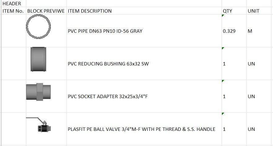

I was only centering the image, this version does all the modified cells

apparently xl has weirdness when it comes to images and alignment with regards to aspect ratio.

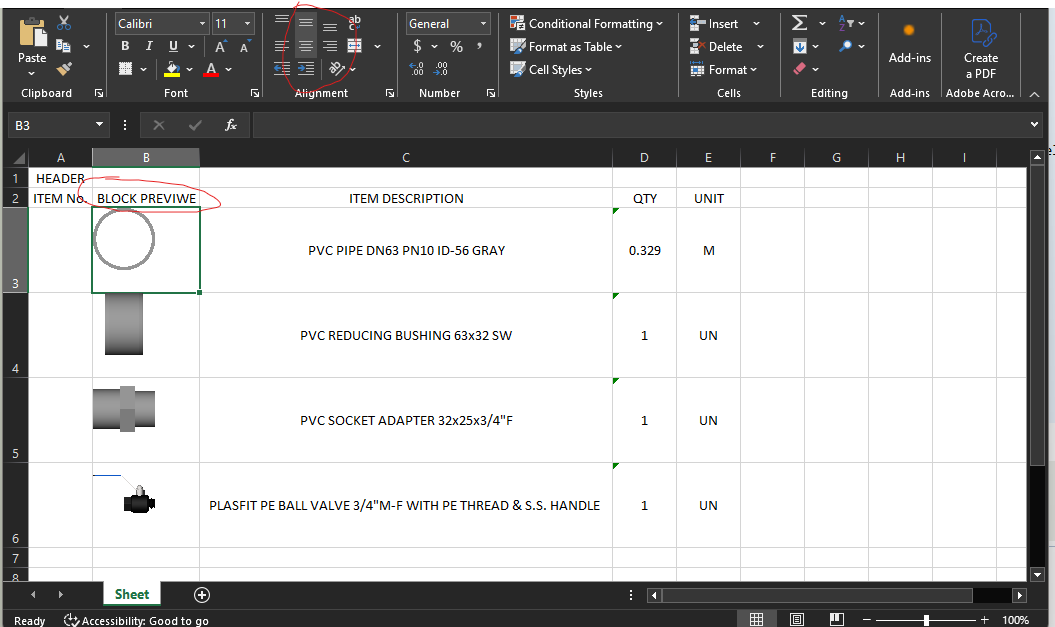

is there a way to set the column width like you set the row height:
ws.row_dimensions[cell.row + 1].height = 64
thanks,
Yes... Align the image within the cell..
It's strange that there is no way to determine the position of the image relative to the cell.
But in any case this is a great program,
many Thanks!!!

I found this
https://stackoverflow.com/questions/13197574/openpyxl-adjust-column-width-size

O.K.,
Got it....
here is the final code with the "getEffectiveNameFromBtrId" function.
@Danielm103  -MANY MANY THANKS FOR YOUR HELP.
#https://www.cadtutor.net/forum/topic/97450-export-table-with-blocks-to-excel-with-python/
from pyrx import Rx, Ge, Gi, Gs, Db, Ap, Ed, Ax
import traceback
from openpyxl.drawing.image import Image as xlImage
from openpyxl.utils.cell import get_column_letter
from openpyxl.styles import Alignment
import openpyxl as xl
import pathlib
import ctypes
import wx
@Ap.Command()
def Py_tablewithimagetoexcel():
    try:
        db = Db.curDb()
        ps, id, _ = Ed.Editor.entSel("\nSelect a table: ", Db.Table.desc())
        if ps != Ed.PromptStatus.eOk:
            raise RuntimeError("Selection Error! {}: ".format(ps))
        # paths
        xlpath = pathlib.Path(db.getFilename()).parent
        xlname = pathlib.Path(db.getFilename()).stem
        #fpt = "{}/{}.png".format(xlpath, xlname)
        fpt = "{}\{}.xlsx".format(xlpath, xlname)
        wb = xl.Workbook()
        ws = wb.active
        table = Db.Table(id)
        opts = Db.TableIteratorOption.kTableIteratorSkipMerged
        for cell in table.cells(opts):
            # format all cells
            currentCell = ws.cell(cell.row + 1, cell.column + 1)
            currentCell.alignment = Alignment(horizontal="center", vertical="center")
            if table.cellType(cell.row, cell.column) == Db.CellType.kBlockCell:
                blk = table.blockTableRecordId(cell.row, cell.column)
                bname = getEffectiveNameFromBtrId(blk)
                print (bname)
                print (blk)
                img: wx.Image = Gs.Core.getBlockImage(blk, 64, 64, 1.0, [0, 0, 0])
                img.SetMaskColour(0, 0, 0)
                img.SetMask(True)
                imgpath = "{}/{}.png".format(xlpath, bname)#blk.handle()
                img.SaveFile(imgpath, wx.BITMAP_TYPE_PNG)
                xlimg = xlImage(imgpath)
                xlimg.width = 64
                xlimg.height = 64
                cellref = "{}{}".format(get_column_letter(cell.column + 1), cell.row + 1)
                ws.add_image(xlimg, cellref)
            else:
                ws.cell(
                    row=cell.row + 1,
                    column=cell.column + 1,
                    value=table.textString(cell.row, cell.column),
        #nested function
        def as_text(value):
            if value is None:
                return ""
            return str(value)
        # make another pass to set the widths + a little extra
        for column_cells in ws.columns:
            length = max(len(as_text(cell.value)) for cell in column_cells)
            ws.column_dimensions[column_cells[0].column_letter].width = length * 1.25
        wb.save("{}/{}.xlsx".format(xlpath, xlname))
        ctypes.windll.user32.MessageBoxW(0, fpt , "Files Saved", 1)
    except Exception as err:
        traceback.print_exception(err)
def getEffectiveNameFromBtrId(btrid: Db.ObjectId):
    rec = Db.BlockTableRecord(btrid)
    if rec.isAnonymous() and rec.hasXData("AcDbBlockRepBTag"):
        for dfx, val in rec.xData("AcDbBlockRepBTag"):
            if dfx == 1005:
                hnd = Db.Handle(val)
                dynid = rec.database().tryGetObjectId(False, hnd)
                dynrec = Db.BlockTableRecord(dynid)
                return dynrec.getName()
    return rec.getName()
aridzv.
got ahead of me in few seconds....😁
thank!!
