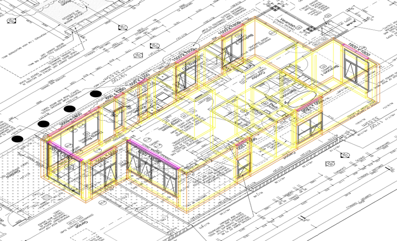

One thing to look at is draw objects not say 4 lines on any layer for a wall, the reason I say that is if you have a draw wall lisp etc then all objects are on correct layers. So also use  blocks which again have all the objects on correct layers. Everything in this image was drawn using a house lisp. All objects are on correct layers, as an example the walls are 4 layers. Have your dim and text styles set up for correct layers. Again a menu or mini lisp functions eg "D25" will be text style 2.5 high and on "Dim25" layer.
