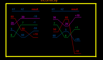

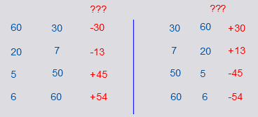

BIGAL Posted April 27 Posted April 27 Comparing rows of text is not a problem it can be done very easy have done many times but this confuses me. How do you pick the two numbers to compare, if it's in order on right examples then must be done in a pick pick manner if its as per "correctly" on right then yes its easy. This one Or this one 1 Quote
Nikon Posted April 27 Author Posted April 27 (edited) @Steven P @BIGAL Thanks for the clarifications. There are just 2 columns with separate text or mtext with numeric values, there can be 2-30 rows in columns... I select the first column - pcm, then the 2nd column - pcm and specify the insertion point of the 3rd column with the result. 1st row of 1st column minus 1st row of 2nd column = 1st row of 3rd column, etc. The above code copes with the task (30 lines or more), but sometimes it crashes and that's why I have to check the result for correctness, so now I can't trust the received values... The interval between the rows does not always match the interval between the rows of the 1st and 2nd columns... Edited April 29 by Nikon Quote
