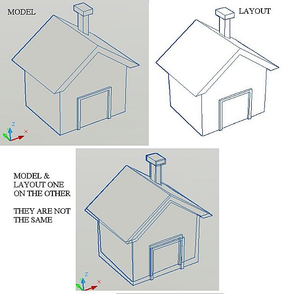

I set a model to a certain view: perspective camera, Field of view, etc... I made a layout of this view, and the layout has is a little different perspective than the model? What's wrong?

May be model perspective view pixel dimension not same to layout pixel dimension.Eg..( 1250 x 850)for model & (1150x 750)for layout!
May we see screen shot?:)
How did you make perspective view for layout?
I always made perspective view in model space and save view.
Then i made layout and made mview and place save view!:)

Your model view looks to just be an isometric, not a true perspective. If you notice in the model, lines are parallel. but in the layout view they converge to vanishing points.
