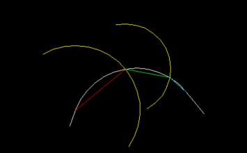

BIGAL Posted May 8, 2025 Posted May 8, 2025 A multi chord different sizes is feasible provided you have an existing arc, you draw a new arc from start point of chord length, then use Intersectwith to get a end point. Repeat as required if point past end then say so. Note in image the small cyan line is balance length. Quote

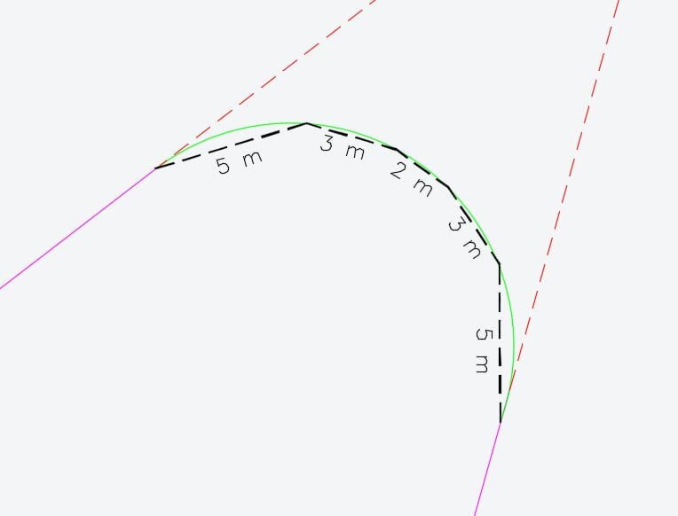

Vica Posted May 8, 2025 Author Posted May 8, 2025 @eldon @JerryFiedler Thank you very much for your interest. An example could be this: Quote

BIGAL Posted May 8, 2025 Posted May 8, 2025 One of those values is in correct in image, it would be a miracle to use the values shown it would only match a certain combination of arc radius and internal angle. If you look at the code by Eldon about chord length it uses an angle, in your image you have 3 angles, 2xang1+ 2xang2+ang3= internal angle, so you have 3 unknowns to solve, I don't think you can solve the angles. Quote
JerryFiedler Posted May 9, 2025 Posted May 9, 2025 (edited) @BIGAL You are correct the total angle of the arc is known, call it X, since we know the angle between the intersecting lines. You are also correct that the total angle is 2xang1+2xang2+ang3 and this equals pi - X. However, we can solve for the angles. I was working on the formulas this afternoon but did not finish. (Have to eat, sleep etc...). You must first calculate the proportions of the chords to the total length of chords. For the example given 5m , 3m and 2m the proportions are 0.277777, 0.166666, 0.11111. You can check that 2xfirst+2xsecond+third =1.00000. It is important to keep in mind that the radius is the same for every chord. If we say A is the total angle of the total arc we can solve for r, the radius of the arc. Chord1 = 5 = 2 * r * sin((0.277777 * A) / 2). Solving for r we know everything about the arcs and angles. We now have all arc lengths 1,2, and 3 so we can determine the points along the total arc where the chords intersect. Once we have the points we can simply create a polyline to show the chords. Tomorrow if I find some free time I will write some lisp code. Edited May 9, 2025 by JerryFiedler Changed to * for multiplication symbol in formula. Quote

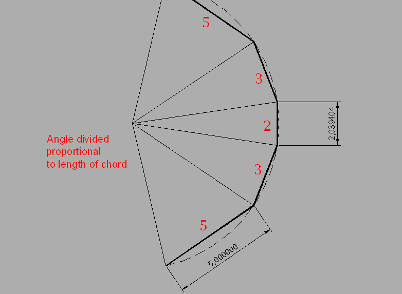

eldon Posted May 9, 2025 Posted May 9, 2025 7 hours ago, JerryFiedler said: ...........You must first calculate the proportions of the chords to the total length of chords.......... I am not sure that this statement can be also applied to the angles subtended by each chord. It is like saying that the chord lengths are proportional to the arc lengths. There is clearly some other factor being introduced. I tried to prove my thoughts in the accompanying picture, I first took an arc (any arc will do because if it works for one then it will work for all). I divided the arc into 18 and took the chord lengths as the number of divisions as the chord length, i.e.5 divisions for the 5 chord, etc Then I scaled everything so that the 5 chord was exactly 5 units long. I measured the 2 chord and it was not 2, but 2.039404. So I think the problem of calculating the radius for differing chord lengths cannot be done by simple proportions. Quote

eldon Posted May 9, 2025 Posted May 9, 2025 56 minutes ago, JerryFiedler said: @eldon You said "any arc will do". To my thinking that is not true. There is one an only one arc with a subtended angle A and chords with the given lengths. Later today I will develop my thoughts further and either prove it or not. Each segment's angle, chord and arc length are all proportional to one another and they all have the same radius. I was trying to prove or disprove a contention that the angle, chord and arc length are linearly proportional, so I was taking an arc at random and not using a specifically chosen one. I think that my findings do cast doubt on equal proportions. When one examines the arc to chord ratio, the expression involves a trigonometric expression. The only factor involved is the angle. The radius appears on both side of the equation and so cancels out. The included angle is the only variable. The closer the angle is to zero, the nearer the chord length equals the arc length. When the angle is 180, then the chord length is the diameter and the arc length is half the circumference. But the rate of change between these limits is not linear. When the chords were equal, as in the original thread, there were linear proportions, but different length chords complicate matters. Undoubtedly equations can be written, but they would be far beyond my ability and I look forward to your efforts. But do not take that as a challenge! Quote
Vica Posted May 9, 2025 Author Posted May 9, 2025 Thanks for the answers. @BIGAL The image I attached is a freehand drawing to help understand my question. The lengths are rounded, but my common sense tells me it should be possible to calculate that combination of chords or any other. @eldon I've considered a solution like this several times, but I finally opted for simpler ones that are within my reach. A tool like this could be useful for future users of this forum. Quote
