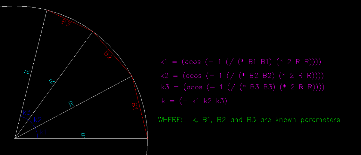

I think there must be an orthodox, elegant, and straightforward way, using a good formulation, to solve this. Perhaps @Jerry Fiedler or someone else will find it at some point.
I've been thinking about this too and have come up with a different approach.
Let me explain:
a) Suppose we have a circle with sufficient dimensions to contain the chords we request.
b) Let's also suppose we calculate the subtended arcs for each of the chords, add them up, and compare the resulting angle with that of the arc into which we will fit those chords.
c) Finally, suppose that depending on the difference, we increase or decrease the radius until that difference is less than 1e-12.
If we manage to solve all this, we will only have to:
- calculate the angular directions, from the center of the arc, of each of the chord ends
- obtain those ends by polars and draw each of the chords
I'm trying to write some code that does this.
I'll publish it soon.
I have developed three equations with the three unknown angles.  Unfortunately they are not linear since there are ratios of sines.  I will start writing a lisp routine tomorrow but I am not a very fast programmer so don't hold your breath.  My method will be similar to @GLAVCVS method since I will be stepping through the three equations using one of the angles until the third equation is zero (fuzz).  It is a rather simple process; hope it works.
Here is my solution to the multi-chord length problem. We have three unknown subtended angles and three equations.  The first equation sums the individual angles:  2*a1 + 2*a2 + a3 = A/2.  The angles a1, a2 and a3 are half the subtended arc associated with chord 1, 2 and 3 and A/2 is half the overall angle.
The chord length is: Ci = 2*rad*Sin(ai) or the half-chord ci = rad*Sin(ai).
Solving for rad = ci / Sin(ai).  This is true for each chord since there is only one radius.  Therefore c1 / Sin(a1) = c2 / Sin(a2)= c3 / Sin(a3).  Taking the first two we get: Sin(a2) = c2*Sin(a1) / c1.
This gives us our second equation: a2 = arcsine( c2*Sin(a1) / c1).
Our third equation: a3 =  arcsine( c3*Sin(a1) / c1).
The code solves the three nonlinear equations for the three unknowns by incrementing angle a1 by a very small value and calculating a2 and a3 until equation 1 is more or less zero. The code uses 2*a1 + 2*a2 + a3 - A/2 --> 0.  Starting with a small a1 this equation is negative so the solution is when the equation flips to positive. I found that stepping a1 by 0.0000005 provided good results. It takes a second or two to solve on my PC but the value can be adjusted for either more accuracy or faster time.
An added feature of this version allows creating either 2, 3, 4 or 5 chords by inputting zero length for chords 2 or 3 or both.  C1 must always have a length.  Refer to the comments at the top of the lisp code.
This code has no error checking. However, if the calculated radius is too large for the selected lines the "fillet" command that draws the arc will throw an error.  I know of no way to correct for this since the routine simply creates a multi-faceted "fillet".  If you can't draw a radius fillet then you cannot  draw a multi-faceted fillet either.  You will have to revisit your geometry.
I think it works but please let me know if you have problems.

Great working out the answer, I thought it would be related to arc length = R * theta.
I may have another go using my prior code of fraction of angle but add the step function reducing or increasing the radius till the last chord distance is correct. This way can do 4 3 2 1 and so on, should be able to do as many chords as wanted rather than just 3 as a pattern.

So, for now, I'll leave a version of <<Extravagant Chords V.1>> that can be run from the command line.
The tool will work on 'LINE's and 'LWPOLYLINE's and should be used, in the latter case, by selecting the end segments of the selected polyline or polylines so that the ends are correctly joined with the calculated chords.
The number of chords to be entered is unlimited
PS: A tool like this, contrary to what @Eldon thinks, if it becomes an option available to a designer or architect, I think it could be used frequently over time.
