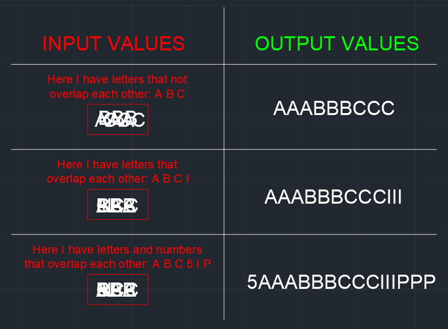

When I use the code from above, I get this (picture 1). ** On the first input values "A B C", they overlap each other, but have a different insertation point for the text entity.

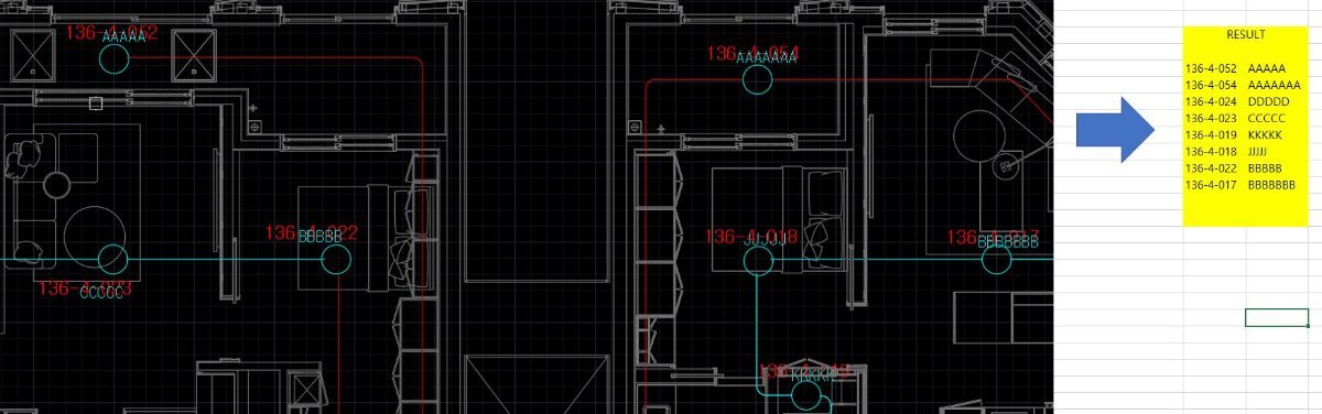

In addition to my first question, I want to get to excel data.
For example,
Input values(in cad)
(overlapping letters) (AAA 111 222) (BBB 333 444) (CCC 555 666) (DDD 777 888 999) .......
Output values(in excel)
AAA 111 222
BBB 333 444
CCC 555 666
DDD 777 888 999
Thank you for reading.
Thank you, Cadtutor and Cadtutor Forum.
God bless all of you.

23 minutes ago, BIGAL said:
Do you mean like this in Excel or all in column A.
YES, YOU'RE RIGHT.
THIS IS CORRECT~ ^^
The example for my question.
It's very difficult question.
The sorting is not major point.
Output is one bundle by one bundle in excel sheet.
one bundle means overlapping letters.
Thank you for your concern.
Edited by GoldSA

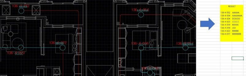

@GoldSA,

Two things to note:
- the firtst one is inside this part of code "(setq ss (ssget (list (cons 0 "*TEXT") (cons 8 "?????") (cons 62 1)))", (cons 8 "?????")", the question marks present the red text values (I can't read the layer name, it is on chineese, but doesn't make a problem for me to performe COMTXTCSV) (picture 1). If the layer name is differnt, you need to put a right name for the layer name inside (cons 8 "?????"), which is the inside "(setq ss (ssget (list (cons 0 "*TEXT") (cons 8 "?????") (cons 62 1)))"".
- the second one is inside this part of code "ssn (ssget "_F" (list minPt maxPt) (list (cons 0 "*TEXT") (cons -4 "<AND") (cons 8 "TEXT") (cons 62 4) (cons -4 "AND>")))" and this part of code "ssn (ssget "_CP" ptlist (list (cons 0 "*TEXT") (cons -4 "<AND") (cons 8 "TEXT") (cons 62 4) (cons -4 "AND>")))", if the layer name is different than "TEXT" inside the "(cons 8 "TEXT")", you need to replace into the correct layer name, and for the "TEXT COLOR" inside the "(cons 62 4)", you also need to replace into the correct color index (picture 2).
After executing the COMTXTCSV command, I get this (picture 3):
