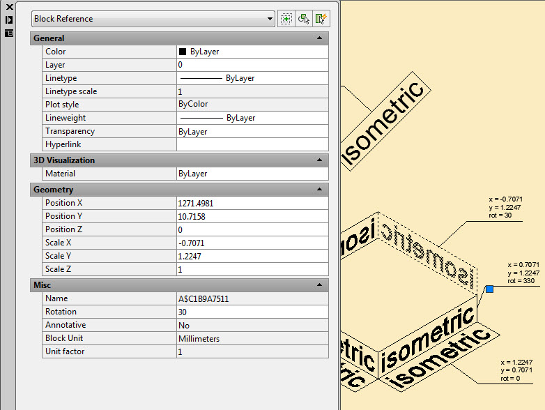

Vagulus Posted September 15, 2013 Share Posted September 15, 2013 Hi Seant I realize this is a very old posting but I am very interested. I don't understand what the scaling has to do with where an object is placed . You can see the text object I have selected and the figures you give for x and y appear to be something to do with scaling! Of even more interest is how you got the text back to front. I's really like to know how you did that one. Thanks Quote Link to comment Share on other sites More sharing options...
SEANT Posted September 15, 2013 Share Posted September 15, 2013 Actually, that particular drawing was done by this threads OP, Maxelkat. The Block Insertion process requires the user to assign specific X, Y, and Z scales. If the use sets the scaling for X, say, then the Reference is the same X scale ad the original Block definition. It can be ½ scale by specifying .5, or 2 times scale by specifying 2. If the user specifies a negative value it will mirror the Block definition about the respective axis. The scales that Maxelkat specified match the foreshortening/stretching associated with Isometric Projection. Quote Link to comment Share on other sites More sharing options...
Maxelkat Posted September 16, 2013 Author Share Posted September 16, 2013 Hi Vagulus The scaling and rotation determine how the flat object is distorted to form the isometric object. This method involves initially rotating your object 45 degrees in order to independently scale in the x and y directions, thereby 'squashing' the object into the correct isometric shape. Any horizontal or vertical distances in the original object will be preserved by the method. If the object has text in it, end either the x or y scaling is negative, this will reverse the text (unless or until you explode it). Another way of getting reverse text is to set the MIRRTEXT variable to 1, and then mirror some ordinary text. Thanks for the interest Maxelkat Quote Link to comment Share on other sites More sharing options...
