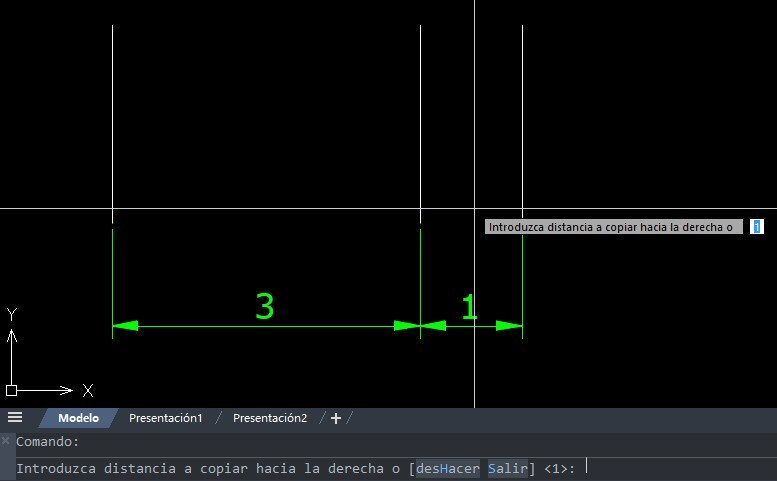

Hello again.
I'm looping the loop with this command.
Now I wish to allow user input for undoing or exiting.
I have detected some issues which I need your help:
1.- distanciastr has disappeared from cursor point and doesn't work anymore by pressing enter. I can't solve it.
2.- when undo, the point for the new copy doesn't come back. Should I keep ptoi and ptof in both lists and call back them with any undo?
Thanks to everyone.

Hi again.
As no one has answered I wonder if I should open a new thread.
Anyway, I have solved the undo problem. (And also osmode and exit minor issues.)
The first problem with distanciastr remains.
Here is the newest code.
Any help or suggestion is well received.
Thank you.

But it still remains a little problem that I can't solve, neither with the AI help:
the options in brackets only appears in commandline.
Is any way to offer the options also in the cursor?
I attach a picture where command line and cursor are shown.
Here is the specific part of the code:
    (setq distanciastr (rtos distancia 2 2))
    (setq tmp (getstring T (strcat "\nIntroduzca distancia a copiar hacia la derecha o [desHacer/Salir] <" distanciastr ">: ")))
(PS: I'm enjoying a lot learning with this.
Thank you everybody.)
