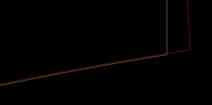

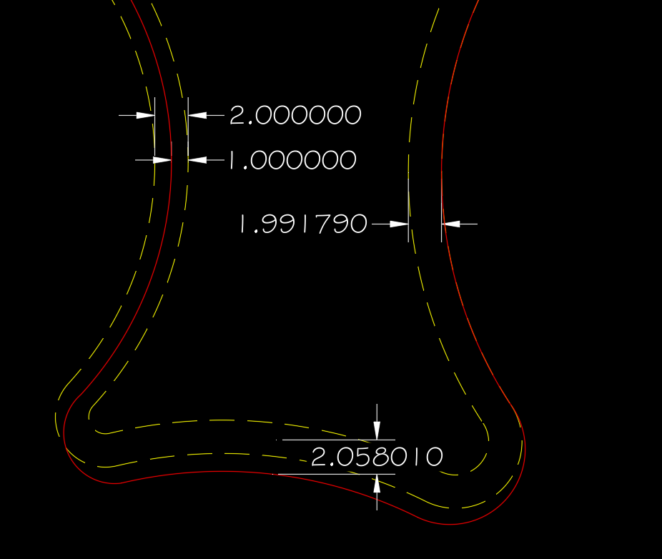

SLW210 Posted June 16, 2025 Author Posted June 16, 2025 The straight on top does correctly. The bottom I offset 4", I had the mouse at 45, the side was 1" I held the mouse very close. Has to do with mouse position from my reading up on this. Also close in shot of the offset at the straight, shows slight variation. It is very good, but requires knowing how to get it close. If I did this wrong please correct me. Quote
SLW210 Posted June 16, 2025 Author Posted June 16, 2025 When I have time I'll work on it more, don't get me wrong, it's very nice. I could live with it as is. Quote
GLAVCVS Posted June 16, 2025 Posted June 16, 2025 (edited) @SLW210 You're right. The problem is that only the mouse distance measurement option is enabled, but not keyboard input. I forgot to add that. I'll fix it right now. ;| Adapted from an original idea by ElpanovEvgeniy 26.02.2010 https://www.theswamp.org/index.php?topic=30650.msg378483#msg378483 ******************* p o r d e s í a r g o ******************** ************************ G L A V C V S ************************* ************************** F E C I T *************************** |; (defun c:offSetea (/ se e pS c? c?c d dk r r1 pu p0 p1 p2 p3 o pt1 pt2 pt3 px1 px2 pa pb ct-r a42 op lgr bd fe *s* para asr dameCentroRadio erroria errores error0) (defun erroria () (defun errores (mens) (setq *error* error0) (entmod fe) (prin1) ) (setq error0 *error* *error* errores ) ) (defun asr (p1 p2 p3 / a b) (if (> (abs (- (setq a (angle p1 p2)) (setq b (angle p2 p3)))) PI) (if (< a b) (if (> (+ a PI PI) b) - +) (if (> (- a PI PI) b) - +) ) (if (> a b) - +) ) ) (defun dameCentroRadio (pt1 pt2 a42 / d radio h aP th centro) (setq radio (/ (setq d (distance pt1 pt2)) (* 2 (sin (/ (setq th (* 4 (atan a42))) 2)))) ; Radio del arco h ((if (> (abs th) PI) - +) (sqrt (- (* radio radio) (* (/ d 2) (/ d 2))))); Distancia del centro al punto medio aP (+ (angle pt1 pt2) (* (/ pi 2) (if (> a42 0) 1 -1))) ; Ángulo perpendicular centro (list (+ (/ (+ (car pt1) (car pt2)) 2) (* h (cos aP))) (+ (/ (+ (cadr pt1) (cadr pt2)) 2) (* h (sin aP)))) ) (list centro radio) ; Devuelve centro y radio ) (erroria) (if (setq se (entsel "\nSelect LWPOLYLINE...")) (if (= (cdr (assoc 0 (entget (setq e (car se))))) "LWPOLYLINE") (progn (setq c? (= (vla-get-closed (setq o (vlax-ename->vla-object (setq e (car se))))) :vlax-true) c?c (equal (vlax-curve-getPointAtParam o (vlax-curve-getStartParam o)) (vlax-curve-getPointAtParam o (setq pu (vlax-curve-getEndParam o))) 1e-6) p1 (fix (vlax-curve-getParamAtPoint o (vlax-curve-getClosestPointTo o (setq pS (cadr se))))) p2 (if (= p1 (1- pu)) (if c? 0 (1+ p1)) (1+ p1)) p0 (if (zerop p1) (if c? (1- pu)) (1- p1)) p3 (if (= p2 pu) (if (or c? c?c) 1) (1+ p2)) pt1 (vlax-curve-getPointAtParam o p1) pt2 (vlax-curve-getPointAtParam o p2) r (vlax-curve-getPointAtParam e (vlax-curve-getParamAtPoint o (vlax-curve-getClosestPointTo o pS))) pt0 (if p0 (vlax-curve-getPointAtParam o p0) (polar pt1 (+ (angle pt1 pt2) (/ PI 2.)) 100)) pt3 (if p3 (vlax-curve-getPointAtParam o p3) (polar pt2 (+ (angle pt1 pt2) (/ PI 2.)) 100)) a42 (cdr (assoc 42 (member (list 10 (car pt1) (cadr pt1)) (setq fe (entget e))))) ) (while (and (not para) (setq lgr (grread nil 13 0))) (if (or (member (cadr lgr) '(107 75)) (= (car lgr) 25) (not (listp (cadr lgr)))) (if (= (car lgr) 25) (setq para (entmod fe) bd T) (if (member (cadr lgr) '(107 75)) (setq *s* (not *s*)) ) ) (if (zerop a42) (setq d (distance (setq r1 (if *s* (progn (entmod fe) (setq para T dk (getreal "\nType the OFFSET distance (ENTER or RIGHT CLICK to indicate point on screen): ")) (getpoint r (if dk "\nSide to act on... " "\nPick a point on the screen... ")) ) (progn (prompt "\rPress \'k\' to activate keyboard input...") (cond ((= (car lgr) 5) (cadr lgr)) ((= (car lgr) 3) (setq para T) (cadr lgr)) ) ) ) ) (setq r (inters pt1 pt2 (polar r1 (setq a (+ (angle pt1 pt2) (/ PI 2.))) 3) (polar r1 (+ a PI) 3) nil)) ) px1 (inters pt0 pt1 (setq pa (polar pt1 (setq a ((asr pt1 r r1) (angle pt1 pt2) (/ pi 2.0))) (if dk dk d))) (setq pb (polar pt2 a (if dk dk d))) nil) px2 (inters pt2 pt3 pa pb nil) ) (setq ct-r (dameCentroRadio pt1 pt2 a42) d (- (distance (if *s* (progn (entmod fe) (setq para T dk (getreal "\nType the OFFSET distance (ENTER or RIGHT CLICK to indicate point on screen): ")) (getpoint r (if dk "\nSide to act on... " "\nPick a point on the screen... ")) ) (progn (prompt "\rPress \'k\' to activate keyboard input...") (cond ((= (car lgr) 5) (cadr lgr)) ((= (car lgr) 3) (setq para T) (cadr lgr)) ) ) ) (setq c (car ct-r)) ) (abs (cadr ct-r)) ) px1 (polar pt1 (angle (if (minusp d) pt1 c) (if (minusp d) c pt1)) (abs (if dk dk d))) px2 (polar pt2 (angle (if (minusp d) pt2 c) (if (minusp d) c pt2)) (abs (if dk dk d))) ) ) ) (if (not bd) (foreach l (list (list p1 (list (car px1) (cadr px1))) (list p2 (list (car px2) (cadr px2)))) (vla-put-coordinate o (car l) (vlax-make-variant (vlax-safearray-fill (vlax-make-safearray 5 '(0 . 1)) (cadr l)))) ) ) ) ) (alert "No LWPOLYLINE selected") ) (alert "NOTHING selected") ) (princ) ) Edited June 16, 2025 by GLAVCVS Filter key inputs 1 Quote
