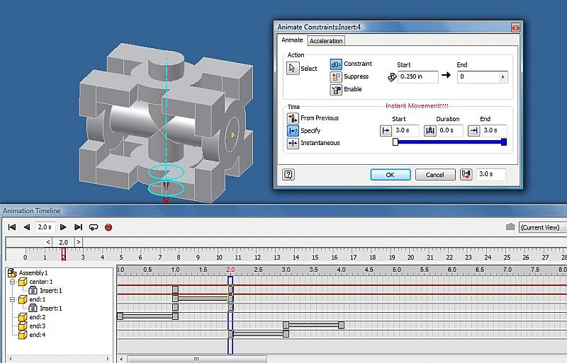

shift1313 Posted April 23, 2009 Share Posted April 23, 2009 okay in this example i went back and changed my insert constraint and gave two of the parts an offset value of .25". In the animation at the beginning and end of these parts "turn" i used animate constraint and gave them an instant movement by changing that .25" offset to 0" then at the end of its turn i did the same thing and brought it back to .25". The only reason i did an instant movement is because i already had the rest of the animation setup but i could have easily altered the numbers to the pieces slid out for a certain duration. cube3.zip Quote Link to comment Share on other sites More sharing options...

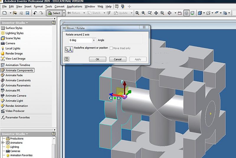

Nitro13 Posted April 24, 2009 Author Share Posted April 24, 2009 I just don't get what you guys mean by using constraints right, like i know im suppose to think of it as being real life. i like want to center a piece so what i do is just put constraints in so it looks right...I'm guessing that is so not right. what constraints should i be using most of the time for fitting these types of pieces in and what should i stay away from? and when sometimes i want to move some objects with the animate components, the triad is not centered. Is there anyway to fix this problem? the move triad only check box never wants to appear =\ Quote Link to comment Share on other sites More sharing options...
shift1313 Posted April 24, 2009 Share Posted April 24, 2009 well with your constraints you just need to be careful not to over constrain something. Going through the help section in the program is probably going to be the best explanation. For instances if you were going to bolt two plates together you could do this with two constraints or you could do this with more. Also your selection during the constraint process will produce different things. for instance if you select a face or a plane as opposed to a line. I would try a few simple exercises to get the hang of animations and constraints. The part you have is complicated. I know you need to have it done by friday but i think a simple example will save you plenty of time in the long run. Quote Link to comment Share on other sites More sharing options...

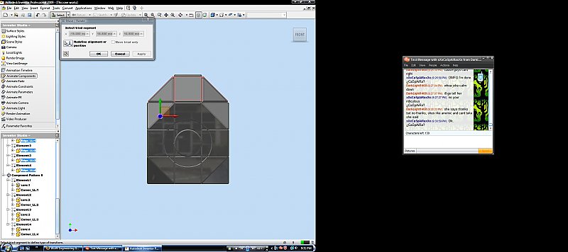

Nitro13 Posted May 5, 2009 Author Share Posted May 5, 2009 Well i do not want to start up a new topic so ill just go off of this one. I have the thing looking awesome and with one layer moving right. The only problem is where it is picking where to rotate the component at in the animate component tab. for all the other selections i have made its centered it every time, but not with this one heres what i mean LOL dual screens fail Quote Link to comment Share on other sites More sharing options...

Robamobabob Posted June 14, 2009 Share Posted June 14, 2009 I really need help with the moving of the triad in studio. I want to center it in the middle of a gear, so I can make it rotate, but the check box I need to click to be able to move it is gray. It's really frustrating, as one of the times I made a gear, the triad went to the middle, so I could rotate it, but now it won't get off the side of the gear. Is there an easier way to rotate objects, or do I need the triad in the center? This is the only thing holding me back at the moment, and it's holding me back from so much fun with this program. Quote Link to comment Share on other sites More sharing options...

Robamobabob Posted June 14, 2009 Share Posted June 14, 2009 Well, it's more of an extension to the last one, as I'm wondering the same thing Shift1313 asked on his last post. I just can't move the triad, because the check box is gray. What I want to center it on is irrelevant, as centering it on the midpoint of a gear should be as easy as centering it on the midpoint of a cylinder or circle. I'm just wondering if there is any way to get that check box usable, or if I have to do it some other way. If it's some other way, I'll need idiot instructions, because I'm more of a visual learner, and it's harder for me to learn by reading or listening... Quote Link to comment Share on other sites More sharing options...

shift1313 Posted June 29, 2009 Share Posted June 29, 2009 Well i do not want to start up a new topic so ill just go off of this one. I have the thing looking awesome and with one layer moving right. The only problem is where it is picking where to rotate the component at in the animate component tab. for all the other selections i have made its centered it every time, but not with this one heres what i mean LOL dual screens fail Did you try simple parts like i suggested? Try to replicate the model i made or something similar to work with. I dont know that you answer my question about how your model was held together and how things will actually work. Knowing how this thing is to be made and assembled is important to setting up constraints and animations. the simple model i drew is at home and i dont have time to draw anything right now but ill try to come back to this later. Quote Link to comment Share on other sites More sharing options...
