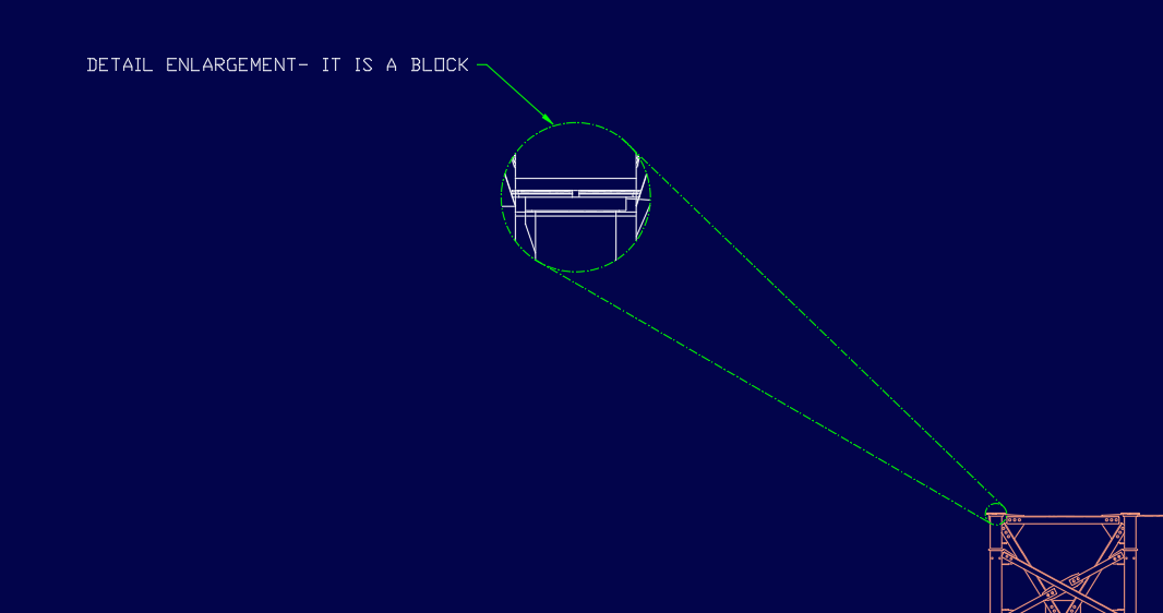

i have this code but it don't work i expected.
It details with a callout line but does not create a new block by drawing it in the circle.

Could you describe what you want the script to do?
I said it above, I want it to do what the posted lisp does but have the circle detail cut out the extra parts.
So the circle will trim all the entities within it?
Apart from this LISP, you might find modelling everything in modelspace and setting up the drawing in paperspace so much more versatile.
For your problem above a viewport in paperspace makes sense, then any changes to the detail will be reflected in the viewport rather than having to recreate the detail block.
Try this as a starter:
Only a small amount of testing but it should create a block from entities within a selected circle - might not trim to every entity though./
You can then scale the block as necessary and add the call out lines manually (can do that with LISP if you think this will work).
A couple of things to modify within the LISP to make it work better. Note as it is you cannot re-use a block name - got to add a check later to make that work
Note can be a bit slow, it used BEdit to work, I could use refedit which will be quicker I think

EX DETAIL.dwg
Your example here works for me as it should, I didn't realise that the detail was a block so there needs to be a little change to the code to account for that. I'll see what I can do today
YES I mean a block, can you modify the code please? thanks a lot
Try this version, if it works OK I'll tidy it up the code
As before, no call out lines, just the circles.

;; Make list of points for not circles, then loop through to break at points
        ) ; end foreach
        (setq acount (+ acount 1))
      ) ; end while                          ;; End while loop
    ) ; end progn
  ) ; end if MySS
  (setq AllBlock (ssget "_X"))              ;; Select everything
  (setq MySS (ssget "_WP" APolyPoints))     ;; Select everything within circle
  (setq DeleteSS (LM:ss-union (list AllBlock MySS))) ;; Delete MySS from AllBlock selection sets
  (command "erase" DeleteSS "" )            ;; Delete everything outside the circle
  (command "_.bsave")
  (command "_.Bclose")
Edited by Steven P
@Steven P just a suggestion, take the circle and use it via polygon to select all objects within, CP, then copy the objects to clipboard,  use bedit, paste objects  use Extrim or cookiecutter to trim to circle.  May need a second select circle in bedit ,save block. Can then insert anywhere.
I just did manually and was reasonably quick.
Will see if can find time to do it as lisp.
Edited by BIGAL
