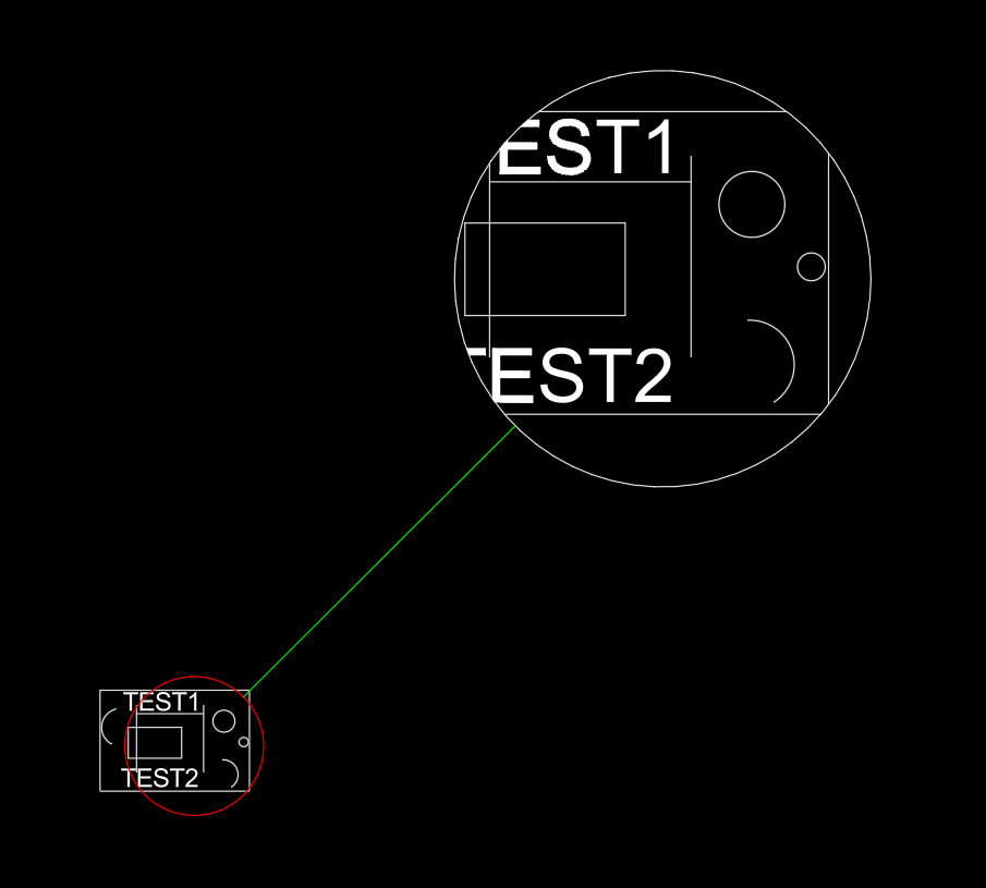

Danielm103 Posted June 23 Posted June 23 (edited) Forgive the Python, only trying to illustrate one possibility. This code creates a spatial filter for a block reference, to simulate a detail. In the image, I created a block of the room, with two references. One has a spatial filter applied and is scaled. You can do the same in lisp, or by hand, make a copy of the block, run the xclip command, draw your polyline perimeter, set XCLIPFRAME to 1 so you can see your frame. instead of a circle, use a polygon with a shape to your liking. My code still needs work as my transformby is wonky(not centered correctly) and I hand drew the leader line lol import traceback from pyrx import Rx, Ge, Gi, Db, Ap, Ed ACDB_INFINITE_XCLIP_DEPTH = 1.0e300 def addFilter_getmat(refid, filter): ref = Db.BlockReference(refid, Db.OpenMode.kForWrite) Db.IndexFilterManager.addFilter(ref, filter) return ref.blockTransform() @Ap.Command() def doit(): try: db = Db.curDb() _ps, refid, _ = Ed.Editor.entSel("\nSelect ", Db.BlockReference.desc()) _ps, cen = Ed.Editor.getPoint("\nGet center: ") _ps, rad = Ed.Editor.getDist(cen, "\nGet radius: ") carc = Ge.CircArc3d(cen, Ge.Vector3d.kZAxis, rad) pts3d, _params = carc.getSamplePoints(20) filter = Db.SpatialFilter() mat = addFilter_getmat(refid, filter) pts2d = [] for pt in pts3d: pt.transformBy(mat) pts2d.append(Ge.Point2d(pt.x, pt.y)) filter.setDefinition( pts2d, Ge.Vector3d.kZAxis, db.elevation(), ACDB_INFINITE_XCLIP_DEPTH, -ACDB_INFINITE_XCLIP_DEPTH, True, ) except Exception as err: print(err) Edited June 23 by Danielm103 2 Quote

SLW210 Posted Tuesday at 03:01 PM Posted Tuesday at 03:01 PM ClipIt (Express Tool) works on blocks, etc. so I got it to work manually. I did do some light reading on automating options in a called Express Tool, so maybe at some point. This works for me, hopefully speeds things up for the OP. Works OP provided .dwg and some quick blocks to test it. ;;; Creates a circular detail clip from a block reference. Copies, scales, and trims to scaled circle (connected by trimmed line). ;;; ;;; https://www.cadtutor.net/forum/topic/98334-detail-circle-in-ms/page/2/#findComment-674313 ;;; ;;;*************************************************************************************************| ;;; | ;;; By SLW210 (a.k.a. Steve Wilson) | ;;; | ;;; MSCirClip.lsp | ;;; | ;;; Uses the Express Tool ClipIt manually (maybe this will be automated at a later time). | ;;; At the prompt-Select the detail circle then select the copied and scaled block. | ;;; At Enter maximum allowable error distance for resolution of arc segments. | ;;; I used 1 and it seems good (smaller is more segments) (see Clipit in Express Tools help). | ;;; | ;;;*************************************************************************************************| ;;; ClipIt creates a pseudo circle of polylines, the connector line will most likely have a gap. | ;;; | ;;; Optionally you could comment the part erasing it. | ;;; | ;;;*************************************************************************************************| ;;; (defun c:MSCIRCLIP (/ ent cen rad circle newPt scaleFactor newRad vec dir pt1 pt2 len scaledBlock detailCircle entsBefore entsAfter diffBlocks ) (vl-load-com) (prompt "\n--- MODELSPACE DETAIL VIEW WITH CLIPIT ---\n") ;; Modelspace entities (defun all-ents () (vl-remove-if 'null (mapcar 'cadr (ssnamex (ssget "_X" '((410 . "Model"))))) ) ) ;; Select block reference (setq ent (car (entsel "\nSelect block reference to detail: "))) (if (not (and ent (= (cdr (assoc 0 (entget ent))) "INSERT"))) (progn (prompt "\nNot a valid block reference.") (exit)) ) ;; Circle center/radius (setq cen (getpoint "\nSpecify center of detail circle: ")) (setq rad (getdist cen "\nSpecify radius of detail circle: ")) (entmakex (list '(0 . "CIRCLE") (cons 10 cen) (cons 40 rad) (cons 62 1) (cons 8 "DETAIL") ) ) ;; Detail location and scale (setq newPt (getpoint "\nSpecify center point for detail view: ")) (initget 7) (setq scaleFactor (getreal "\nEnter detail scale factor (e.g. 2): ")) (setq newRad (* rad scaleFactor)) ;; Copy and scale block (command "COPY" ent "" cen newPt) (setq scaledBlock (entlast)) (command "SCALE" scaledBlock "" newPt scaleFactor) ;; Clipping circle (setq detailCircle (entmakex (list '(0 . "CIRCLE") (cons 10 newPt) (cons 40 newRad) (cons 62 1) (cons 8 "DETAIL") ) ) ) ;; Run CLIPIT manually (prompt "\n>>> Run CLIPIT: Select the detail circle and the new (scaled) block.\n" ) (C:CLIPIT) ;; Delete temp circle after CLIPIT (if (and detailCircle (entget detailCircle)) (entdel detailCircle) ) ;; Draw connector line (setq vec (mapcar '- newPt cen)) (setq len (distance cen newPt)) (setq dir (mapcar '/ vec (list len len len))) (setq pt1 (mapcar '+ cen (mapcar '* dir (list rad rad rad)))) (setq pt2 (mapcar '- newPt (mapcar '* dir (list newRad newRad newRad)) ) ) (entmakex (list '(0 . "LINE") (cons 10 pt1) (cons 11 pt2) (cons 62 3) (cons 8 "DETAIL") ) ) (prompt "\nDetail view created and connector drawn.\n") (princ) ) Quote

SLW210 Posted Tuesday at 03:46 PM Posted Tuesday at 03:46 PM You need to read the instructions. Select the CIRCLE, then Select the BLOCK, then input the max allowable error distance value (I used 1). At the prompt-Select the detail circle then select the copied and scaled block. At Enter maximum allowable error distance for resolution of arc segments. I used 1 and it seems good (smaller is more segments) (see Clipit in Express Tools help). Post one of your blocks, it works on some blocks I created to test. Quote
jim78b Posted Wednesday at 05:35 AM Author Posted Wednesday at 05:35 AM 13 hours ago, SLW210 said: You need to read the instructions. Select the CIRCLE, then Select the BLOCK, then input the max allowable error distance value (I used 1). At the prompt-Select the detail circle then select the copied and scaled block. At Enter maximum allowable error distance for resolution of arc segments. I used 1 and it seems good (smaller is more segments) (see Clipit in Express Tools help). Post one of your blocks, it works on some blocks I created to test. I tried your code and i did as It request. But no circle block detail Is created.sorry today i try again . Quote
jim78b Posted Wednesday at 06:46 AM Author Posted Wednesday at 06:46 AM (edited) 15 hours ago, SLW210 said: You need to read the instructions. Select the CIRCLE, then Select the BLOCK, then input the max allowable error distance value (I used 1). At the prompt-Select the detail circle then select the copied and scaled block. At Enter maximum allowable error distance for resolution of arc segments. I used 1 and it seems good (smaller is more segments) (see Clipit in Express Tools help). Post one of your blocks, it works on some blocks I created to test. ok thanks i tested and worked! only one question...it don't work on nested blocks? Edited Wednesday at 06:49 AM by jim78b Quote
