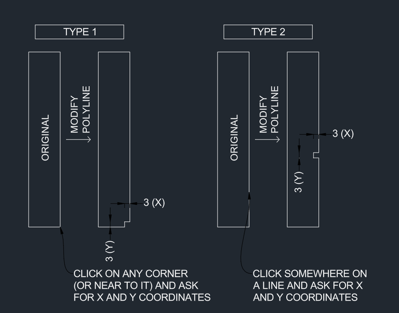

swanny89 Posted October 18, 2025 Posted October 18, 2025 Hi all, Long story short, I waste tens of hours per year creating "quirks" in polylines, and I'm hoping that this could be automated using a LISP....problem is I have no idea where to start when it comes to manipulating geometry with LISP (or even if what I'm trying to achieve is possible). I'm wondering if anyone has a lisp, or could create a lisp (I will be eternally grateful) that can modify a polyline in a specific manner. The image below shows what I'm trying to achieve. I'd love to have 2 lisps. One to do corners (type 1 - calld "quirkc" ) and another to do lines (type 2 - called "quirkl"). The functionality I'd like to achieve in these LISPS is as follows; 1. Activate the lisp 2. Pick a point on the line or the corner (these geometries are polylines or closed polylines) 3. Have a prompt appear asking for width (x) and height (y) 4. modify the polyline as shown (create additional points in the polyline offset the required x and y distances) Thank you in advance for any help you can provide (or simply telling me this is not possible). Quote

swanny89 Posted October 19, 2025 Author Posted October 19, 2025 @devitg Thank you for taking the time to look into this for me! Attached is a copy of the dwg with the basic geometry (before and after). I'd say in 90% of cases the rectangles would be orthogonal like you say, but sometimes they can be at any angle. If we could capture the 90% use case that would be hugely beneficial on it's own. Quirk.dwg Quote
devitg Posted October 19, 2025 Posted October 19, 2025 @swanny89 I guess both values W H could be different ? Quote

swanny89 Posted October 20, 2025 Author Posted October 20, 2025 @Tsuky Thank you so much this is absolutley amazing! It doesn't allow the width and height to be specified independantly, but considering that the vast mojority of the time these are the same it's really no issue at all to just adjust them when required. Again, thank you Quote
swanny89 Posted October 20, 2025 Author Posted October 20, 2025 @Ajmal Thank you this is equally amazing! I now have two versions that cover all scenarios. I can use @Tsuky's version when the quirk dimensions are equal as this version doesnt require as much user input. Then, for the more unusual quirks I can switch to your version and specify the parameters. Thanks guys problem solved! I'm sure I'll come up with a new problem soon Quote
