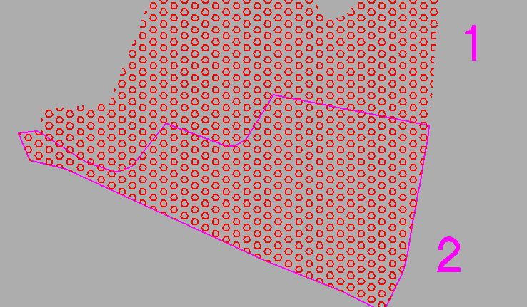

Thew Posted October 18, 2025 Posted October 18, 2025 Hello, in the attached DWG drawing there was already a hatch, I drew a new one at the bottom, which should have the same properties, but I can't assign them. I tried with the brush, it doesn't work; with edit hatch I can't identify the exact scale of the original hatch, and if I try to change the scale of the new hatch, it disappears. I would like to ask how I could solve the problem. Thank you. Tratteggi.dwg Quote
Steven P Posted October 18, 2025 Posted October 18, 2025 It might be the way it downloaded for me, but the original hatch, 1, appears to be a block (anonymous block), so when you apply the format painter all it will copy are settings common to a block and a hatch - layer, line type and so. Explode the block and it turns into lines rather than a hatch. Quote

eldon Posted October 19, 2025 Posted October 19, 2025 In your drawing, area 1 is, as stated by @Steven P, a block which has lines from an exploded hatch. Area 2 is a standard hatch pattern HEX and scale of 1. If you measure one side of the hexagon in each of the areas, you will find the scale of area 1 is equivalent to a scale of 10. I don't know why your hatch in area 2 disappears when you scale it. Perhaps you are trying a scale number that is too large. Quote
