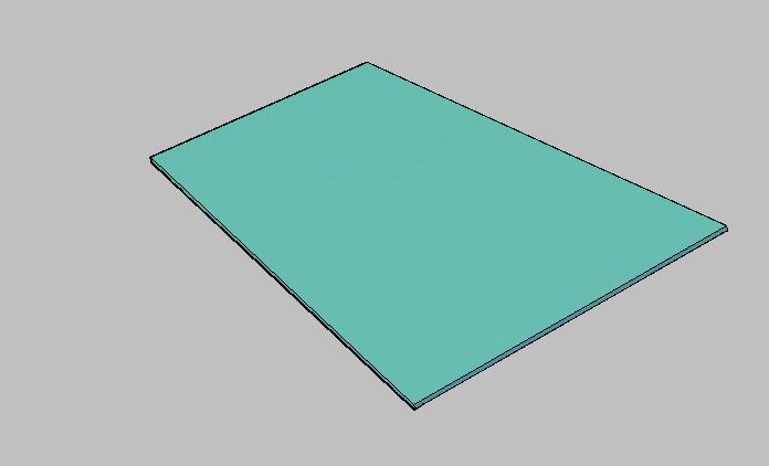

Jrose Posted April 24, 2009 Posted April 24, 2009 Hey everyone, I was wondering if someone can show me how to create this surface. It is curved as you can see and it needs to be a solid about 0.12 thick. This is the exact size that I need to create. I tried just about everything andI can't figure it out. If anyone can show me I appreciate it Thanks Surface.dwg Quote

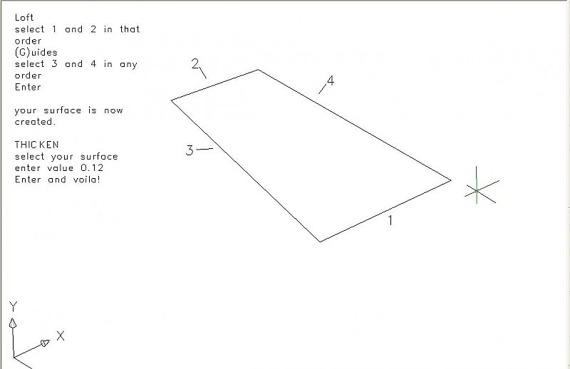

shift1313 Posted April 24, 2009 Posted April 24, 2009 It is very simple to do with all the lines you have. Follow what i wrote in the first attached image and you should get whats in the second image. Quote
Jrose Posted April 24, 2009 Author Posted April 24, 2009 It is very simple to do with all the lines you have. Follow what i wrote in the first attached image and you should get whats in the second image. Shift1313, I tried it but this is what came up. Command: loft Select cross sections in lofting order: Specify opposite corner: 1 found Select cross sections in lofting order: 1 found, 2 total Select cross sections in lofting order: 1 found, 3 total Select cross sections in lofting order: 1 found, 4 total Select cross sections in lofting order: Enter an option [Guides/Path/Cross sections only] : Which one do I select from here and what steps do i take next. Thanks Please advice. Quote
shift1313 Posted April 24, 2009 Posted April 24, 2009 okay, do as follows type LOFT Select the lines i labeled as 1 and 2 then hit Enter type the letter G Select lines 3 and 4 and hit Enter when you are lofting you are taking one line(#1) and stretching it out to line(#2). your guides(not needed in this case) are the lines labeled 3 and 4. If you cant get this to work try again by typing LOFT, select line 1 then line 2, and then hit your enter key 3 times. let me know if this works. I think what you did was select all 4 lines and that is not a valid setup for lofting. when i put (G)uides i should have specified to hit G for the guide option Quote

Jrose Posted April 24, 2009 Author Posted April 24, 2009 okay, do as followstype LOFT Select the lines i labeled as 1 and 2 then hit Enter type the letter G Select lines 3 and 4 and hit Enter when you are lofting you are taking one line(#1) and stretching it out to line(#2). your guides(not needed in this case) are the lines labeled 3 and 4. If you cant get this to work try again by typing LOFT, select line 1 then line 2, and then hit your enter key 3 times. let me know if this works. I think what you did was select all 4 lines and that is not a valid setup for lofting. when i put (G)uides i should have specified to hit G for the guide option Shift1313, I tried it. It worked, but now there is a problem. It won't give me a thickness. Please advice. Thanks Quote
shift1313 Posted April 24, 2009 Posted April 24, 2009 type THICKEN in the command line. Select your Surface enter your value 0.12 press Enter Quote
Jrose Posted April 24, 2009 Author Posted April 24, 2009 type THICKEN in the command line. Select your Surface enter your value 0.12 press Enter Shift1313, Thanks Matt right. It took me a while, but it worked. You THA MAN! Thanks DUDE! JR. Quote
