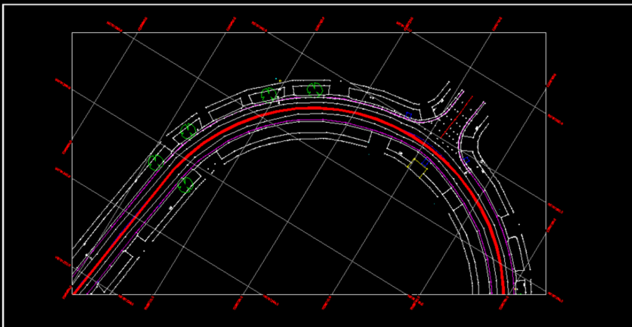

Hi all!
I'm trying to show a grid in a viewport that's identical to the model space. In the model space I have the scale set to 1:50. Grid spacing set to 50 and Display grid beyond Limits checked. The same settings applied in the viewport doesn't show the grid, however if I set grid spacing to 100 it  shows. Is grid spacing 50 not possible?
Do you want a hard drawn grid for your viewport ? It can have a twist.
Can you post the drawing?
What's the GRIDDISPLAY (System Variable) set to in the drawing?
By default it turns on adaptive grid display, which limits the density of the grid when zoomed out.
