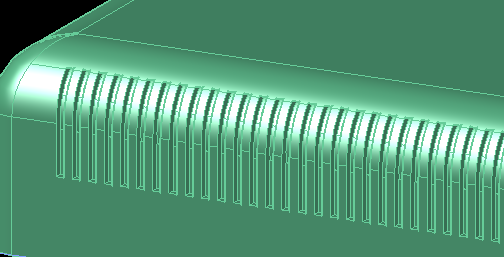

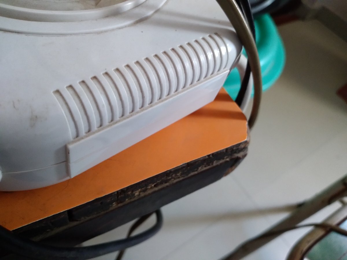

I tried a lot. But I could not succeed to draw L shaped ribs shown in the model. I drew  big solid and L shaped rib.17773575933351278237312797597594.thumb.jpg.60ceb1778db0dea38731780e6ff48192.jpg Then did union. But could not fillet later. I also tried fillet first. But could not subtract Lshaped rib from the big solid. Kindly help me.

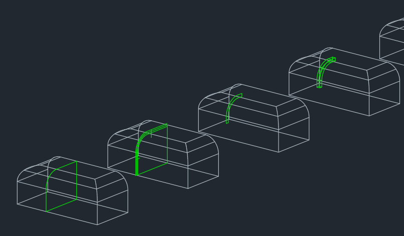

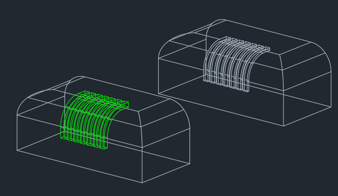

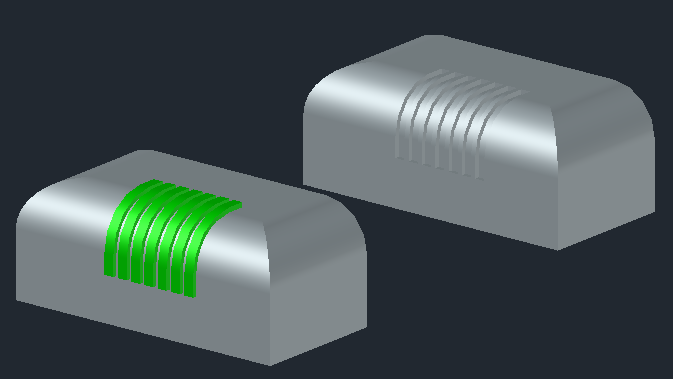

Here's one method similar to @hemal
both side
  1. Use section to create the green section cut as shown below.
  2. Set the UCS to the plane of the setion.
  3. Offset to both sides of the section and trim shape. Note, offsetting to both sides ensures that the resulting solids will penetrate the surface and not be just flush with it.
  4. Convert to polyline.
  5. Extrude.
   6. Array
  7. Subtract.
Thank you @irm.Your method works perfrctly fine. I did it accordingly, and perfectly done. Once again Thank you very much.
