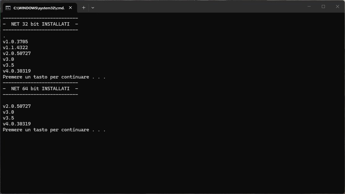

X11start Posted May 8 Author Posted May 8 I tried to check which versions of .Net are installed: it seems unusual to me that the latest is 4.0.3 (the version 10 came out in April!). My colleagues with the same versions have no problems. It might be advisable to install more recent versions: I'm afraid of causing damage! Quote
