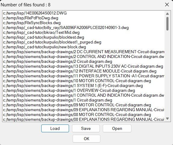

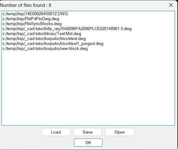

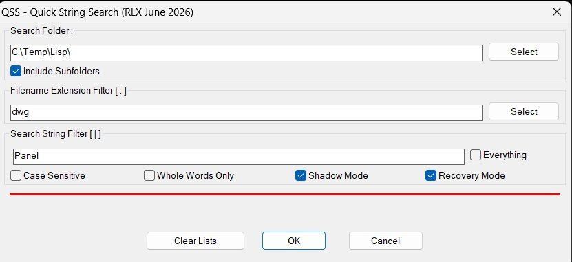

;;; QSS - Quick String Search Rlx June'26
;;; Just a basic string search engine, first meant for text based files like lsp & txt files + dwg files (dbx)
;;; Some files are read as stream so maybe it also works for other file types ... bucketlist material.
;;; App can skip (error-catch) files its unable to open because they were saved with higher version.
;;; Sometimes files can be corrupt and AutoCad crashes and you would loose all search results fo far.
;;; Thats why I created shadow mode and recovery mode.
;;; Shadow mode writes a file (QSS-Shadow-List.txt) on your desktop in 'QuickStringSearch' folder where the name of each file is saved.
;;; Each line begins with <num> | status | filename. You can save this file as csv and split on pipesymbol |.
;;; Status can be 0 - corrupt , 1 - unable to open , 2 - no hit , 3 - hit (search string was found)
;;; I created this because I was searching little over one hundred thousand drawings and just before it was finished
;;; it crashed AutoCad because of a corrupt drawing. With shadow mode you can now see how far it came.
;;; To be able to get past this , I also created recovery mode.
;;; First all filenames are saved to file (QSS-Recovery-List.txt) , then this list is compared to the shadow list.
;;; With this info , app can tell which file caused the crash , sent it to my naughty list , and resume with the rest.
;;; Normal operation , no corrupt files is simple click and go. You can allways leave on Shadow mode.
;;; When however AutoCad crashed because of corrupt file , switch on recovery mode and app will be able to
;;; skip corrupt file and resume with the rest.
;;; Last update		: 2026-05-18 - added eror catch for read excel values
;;;			: 2026-05-30 - added Shadow Mode, save results do desktop (QSS-Shadow-Mode.txt)
;;;			: 2026-06-01 - added Recovery Mode, resume search after crash & find everything

           (QSS-Whole-Words-Only "tg_whole_words_only")
           (QSS-Shadow-Mode "tg_shadow_mode")
           (QSS-Recovery-Mode "tg_recovery_mode")
  ;;; rd = reset data (val1 val2 ...) , in case of a cancel store original values before start of dialog
  (if (null MainDialog-rd) (setq MainDialog-rd (Save_Dialog_Data MainDialog-tl)))
  ;;; set edit boxes and toggle values
  (Set_Dialog_Tiles MainDialog-tl)
  ;;; show mode in color
  (show_program_mode)
(defun QSS_Main_Dialog_Action ()
  (mapcar '(lambda (x)(action_tile (car x) (cadr x)))
    '(("cancel" "(done_dialog 0)")
      ;;; stay in dialog for progress bar
      ;;; ("accept" "(done_dialog 1)")
      ("accept" "(WriteSettingsToRegistry)(if (eq QSS-Get-Everything \"1\")(QSS_Get_Everything)(QSS_Pre_Scan))")
      ("eb_search_folder" "(setq QSS-Search-Folder $value)")
      ("bt_select_search_folder" "(QSS_select_search_folder)")
      ("tg_include_subfolders" "(setq QSS-Include-Subfolders $value)")
      ("eb_filename_extension_filter" "(setq QSS-Filename-Extension-Filter $value)")
      ("bt_filename_extension_filter" "(QSS_Select_Filename_Extension_Filter)")
      ("eb_search_string_filter" "(setq QSS-Search-String-Filter $value)")
      ("tg_everything" "(setq QSS-Get-Everything $value)")
      ("tg_case_sensitive" "(setq QSS-Case-Sensitive $value)")
      ("tg_whole_words_only" "(setq QSS-Whole-Words-Only $value)")
      ("tg_shadow_mode" "(setq QSS-Shadow-Mode $value)(show_program_mode)")
      ("tg_recovery_mode" "(setq QSS-Recovery-Mode $value)(show_program_mode)")
      ("bt_clear_lists" "(QSS_Clear_Lists)")
(defun show_program_mode ( / col )
  (setq col (cond ((= QSS-Recovery-Mode "1") 1) ((= QSS-Shadow-Mode  "1") 3)(t 7)))
  (start_image "im_mode") (fill_image 0 0 (dimx_tile "im_mode") (dimy_tile "im_mode") col)(end_image)

Most info included in lisp file. Just a quick string search for lsp, txt & dwg files.
Start with QSS , select folder , extension like lsp,dwg and search string like Rlx
Type in extensions like lsp,txt (with comma) and for text use pipe symbol like Rlx|Dragon
for now only lsp,txt and dwg are supported , haven't been able to make it work on pdf
I have added a couple of toggles , Shadow mode , Recovery & Everything.
Shadow mode writes a log file for every file that is searched. Next to it is Recovery.
When searching oh lets say 100.000+ files and one of the files is corrupt AutoCad crashes and all previous results are poof...
When this happens start AutoCad again , select Recovery , and app will continue the search by comparing the complete file-list
with the shadow list and can work out from where to continue and put corrupt drawing on the naughty list.
These files are saved on desktop in QuickSearchFolder.
If a drawing was saved with a higher version I can error-catch that but when a file is corrupt lisp can't handle that so hence the recovery option.
When multiple drawings are corrupt you have to repeat this process as many times until app reaches the finish line.
When the list pops up you only see the matches found from the last successful run, click on the load button and shadow list is read again et voila.
When 'Everything' is selected all text from all files (drawings) are saved to a text file.
Button Clear Lists in main dialog deletes all files from desktop folder so you can start as fresh as a baby's butt (after a bath of course)
