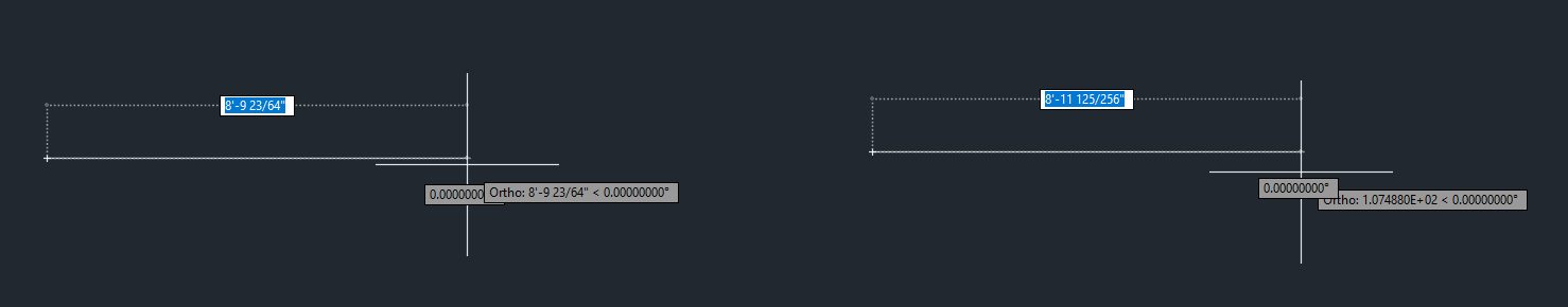

JDowls Posted 17 hours ago Posted 17 hours ago Looking for a little help with something that has been frustrating me over the last few months. Started a new job, AutoCAD already configured on the laptop. For the life of me, I cant figure out why the dynamic/pointer input switches between Architectural units and Scientific units while the mouse moves. For example drawing a line, sometimes it shows the arch units (8'-9 23/64") and sometimes it shows scientific (1.074880E+02). This is the same polyline command, just moving the mouse a bit further right. Does anyone know how to fix this? Quote
SLW210 Posted 2 hours ago Posted 2 hours ago It's actually acting correctly, according to Autodesk. Move in a straighter line and/or adjust precision. Better explained at Displacement Dimensions changing. Quote
