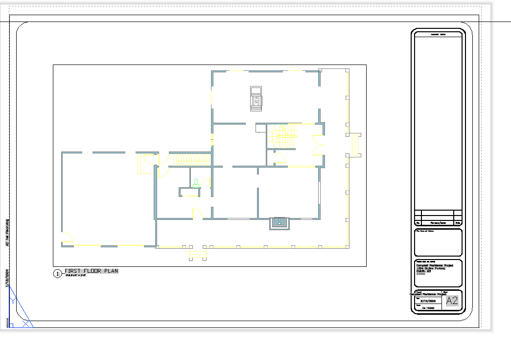

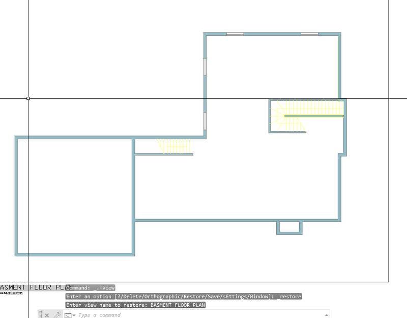

correct. Here's a few of the files. Right now I'm having an issue with missing dimensions and furniture blocks when I upload the drawings into sheets from model space. I made sure no layers were frozen, nothing is on def points, ran an audit....etc Flr-B.dwg Flr-1.dwg FLR-2.dwg Exterior Elevations corrected.dwg Site plan Alternate.dwg Wall Section.dwg Building section.dwg Stair Detail.dwg -
Alright, another Penn Foster student here. Big shocker there, I know. I put all my drawings from model space in to sheets but I lost all my dimensions and some of my furniture blocks. I double checked to be sure I didn't have any frozen layers, nothing is in def points, they're in correct layers, I ran an audit and it found and fixed 0 errors. I'm really new to all this auto cad stuff but apparently my work thinks I need it even though ill never use it. I'm not even ALOUD to have it on my computer at work...lol Any help would be greatly appreciated Flr-B.dwg Flr-1.dwg FLR-2.dwg
