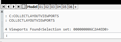

if your trying to select all Paperspace viewports at once. this filters all viewports that are not in model or the first (paperspace) (defun C:CLV () (C:CollectLayoutViewports)) (defun C:CollectLayoutViewports (/ ss) (if (not (setq ss (ssget "_X" '((0 . "VIEWPORT") (410 . "~Model") (-4 . ">") (69 . 1) (-4 . ">") (68 . 0))))) (princ "\nNo Active Paperspace Viewports Found") (princ (strcat "\n" (itoa (sslength ss)) " Viewports Found")) ) ss )

if you're only looking for true rectangular vports then testing for the dxf 340 is the best way to filter that out.

That didn't work but I notice some have code 340, other don't (Clipping boundary) so filtering post ssget worked... Just not exactly sure this true in every case. (defun c:CollectLayoutViewports (/ ss i ent ed layout number status pt items counts item) (setq items nil ss (ssget "_X" '((0 . "VIEWPORT") (67 . 1))) ) (princ (strcat "\nSelection count: " (if ss (itoa (sslength ss)) "0"))) (if ss (progn (setq i 0) (while (< i (sslength ss)) (setq ent (ssname ss i) ed (entget ent) layout (cdr (assoc 410 ed)) ) (if (and layout (/= (strcase layout) "MODEL") (assoc 340 ed)) (setq items (cons ent items)) ) (setq i (+ i 1)) ) ) ) (princ (strcat "\nResult count: " (if items (itoa (length items)) "0"))) )

Try this selection filter which should remove the paperspace object itself which is also considered as a vport (ssget "_X" '((0 . "VIEWPORT") (67 . 1) (-4 . "/=") (69 . 1)))
I'm trying to select all the true view port in each layout but I'm running into issues. There are more view ports in the drawing than what's visible to the user(not sure why this is as I only create one single view port in each layout). So I need to filter for the actual view ports. (defun c:CollectLayoutViewports (/ ss i ent ed layout number status pt items counts item) (setq items nil counts nil ss (ssget "_X" '((0 . "VIEWPORT") (67 . 1))) ) (princ (strcat "\nSelection count: " (if ss (itoa (sslength ss)) "0"))) (if ss (progn (setq i 0) (while (< i (sslength ss)) (setq ent (ssname ss i) ed (entget ent) layout (cdr (assoc 410 ed)) number (cdr (assoc 69 ed)) status (cdr (assoc 68 ed)) pt (cdr (assoc 10 ed)) ) (if (and layout (/= (strcase layout) "MODEL") (> number 1) (> status 0)) (progn (setq items (cons ent items)) ) ) (setq i (+ i 1)) ) ) ) items ) is there a DXF code I can filter by or any other suggestion... ViewPortTest.dwg
