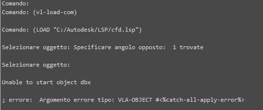

You're welcome @X11start If you want options for rename you can try this copy for dragons version ;;; copy for dragons- rlx 2025-10-18 (defun c:cfd ( / this-dwg ss other-dwg blocknames-in-selectionset blocknames-in-other-dwg duplicate-blocknames dbx-doc) (setq this-dwg (vla-get-ActiveDocument (vlax-get-acad-object))) (if (and (setq ss (ssget)) (setq other-dwg (getfiled "Copy SS to:" "" "dwg" 0))) (progn (if (vl-consp (setq blocknames-in-selectionset (Get_SS_BlockNames ss))) (setq blocknames-in-selectionset (mapcar 'strcase blocknames-in-selectionset))) (if (vl-consp (setq blocknames-in-other-dwg (Get_DBX_Blocknames other-dwg))) (setq blocknames-in-other-dwg (mapcar 'strcase blocknames-in-other-dwg))) (setq duplicate-blocknames (compare_block_names blocknames-in-selectionset blocknames-in-other-dwg)) (if (vl-consp duplicate-blocknames) (progn (dplm duplicate-blocknames "Duplicated block names : ") ;;; (if (yes_no "Copy anyway?") (ctd ss other-dwg) (princ"\nBite me...") ) (setq inp (cfl (list "1 - Copy anyway" "2 - Rename blocks in this dwg" "3 - Rename blocks in other dwg" "4 - Never mind"))) (cond ((void inp) (princ "\nNever mind")) ((wcmatch inp "1*") (ctd ss other-dwg)) ((wcmatch inp "2*") (foreach b duplicate-blocknames (rename_block_definition b)) (ctd ss other-dwg)) ((wcmatch inp "3*") (dbx_rename_block_definitions duplicate-blocknames other-dwg) (ctd ss other-dwg)) (t (princ"\nBite me...")) ) ) (ctd ss other-dwg) ) ) ) (princ) ) ; check if $member exists in (vla-) %collection (defun Collection-Member ( $member %collection / result) (if (vl-catch-all-error-p (setq result (vl-catch-all-apply 'vla-item (list %collection $member)))) nil result)) (defun create_unique_blockname ( $bn / i bn) (setq i 0)(while (tblsearch "block" (setq bn (strcat $bn "_" (itoa (setq i (1+ i))))))) bn) (defun rename_block_definition ( $bn / bn ) (if (and (not (void $bn)) (tblsearch "block" $bn)) (vla-put-name (Collection-Member $bn (vla-get-blocks (vla-get-ActiveDocument (vlax-get-acad-object)))) (setq bn (create_unique_blockname $bn)))) bn) (defun compare_block_names (a b / c) (and (vl-consp a) (vl-consp b) (foreach item a (if (member item b) (setq c (cons item c))))) c) (defun Get_SS_BlockNames ( ss / n l) (foreach o (ss->ol ss) (if (and (block-p o)(not (member (setq n (block-n o)) l))) (setq l (cons n l)))) l) (defun SS->OL (ss / i l)(setq i 0)(repeat (sslength ss)(setq l (cons (vlax-ename->vla-object (ssname ss i)) l) i (1+ i))) l) (defun void (x) (or (eq x nil)(and (listp x)(not (vl-consp x)))(and (eq 'STR (type x))(eq "" (vl-string-trim " \t\r\n" x))))) ; (block-p (vlax-ename->vla-object (car (entsel)))) (defun block-p (o) (and (= 'vla-object (type O))(eq (vla-get-objectname O) "AcDbBlockReference"))) (defun block-n (o) (if (and (= 'vla-object (type O))(eq (vla-get-objectname O) "AcDbBlockReference")) (if (vlax-property-available-p o 'EffectiveName)(vla-Get-EffectiveName o)(vla-Get-Name o)) nil)) ; (yes_no "Do you like snow") (defun yes_no ( $m / f p i r ) (and (= (type $m) 'STR) (setq f (vl-filename-mktemp ".dcl")) (setq p (open f "w")) (write-line (strcat "yesno:dialog{label=\"" $m "?\";ok_cancel;}") p) (progn (close p)(gc) t) (setq i (load_dialog f)) (new_dialog "yesno" i) (progn (action_tile "accept" "(done_dialog 1)")(action_tile "cancel" "(done_dialog 0)") (setq r (start_dialog))(unload_dialog i)(vl-file-delete f) t)(if (= r 1) t nil))) ;;; choose from list (cfl '("1""2""3")) (defun cfl (l / f p d r) (and (setq p (open (setq f (vl-filename-mktemp ".dcl")) "w")) (princ "cfl:dialog{label=\"Choose\";:list_box{key=\"lb\";width=40;}ok_cancel;}" p) (not (setq p (close p)))(< 0 (setq d (load_dialog f)))(new_dialog "cfl" d) (progn (start_list "lb")(mapcar 'add_list l)(end_list)(action_tile "lb" "(setq r (nth (atoi $value) l))(done_dialog 1)") (action_tile "accept" "(setq r (get_tile \"lb\"))(done_dialog 1)")(action_tile "cancel" "(setq r nil)(done_dialog 0)") (start_dialog)(unload_dialog d)(vl-file-delete f))) (cond ((= r "") nil)(r r)(t nil))) ;;; display list (plus message) (defun dplm (l m / f p d w) (and (vl-consp l) (setq l (mapcar 'vl-princ-to-string l)) (setq w (+ 5 (apply 'max (mapcar 'strlen l)))) (setq p (open (setq f (vl-filename-mktemp ".dcl")) "w")) (princ (strcat "cfl:dialog{label=\"" m "\";:list_box {key=\"lb\";" "width="(itoa w)";}ok_only;}") p)(not (setq p (close p)))(< 0 (setq d (load_dialog f)))(new_dialog "cfl" d)(progn (start_list "lb") (mapcar 'add_list l)(end_list)(action_tile "accept" "(done_dialog)")(start_dialog)(unload_dialog d)(vl-file-delete f)))) ;;; copy to drawing (defun ctd ( ss dwg / ss->ol dbx_ver acApp acDoc dbx object-list object-safe-array) (defun SS->OL (ss / i l) (setq i 0)(repeat (sslength ss)(setq l (cons (vlax-ename->vla-object (ssname ss i)) l) i (1+ i))) l) (defun dbx_ver ( / v) (strcat "objectdbx.axdbdocument" (if (< (setq v (atoi (getvar 'acadver))) 16) "" (strcat "." (itoa v))))) (setq acApp (vlax-get-acad-object) acDoc (vla-get-ActiveDocument acApp)) (setq dbx (vl-catch-all-apply 'vla-getinterfaceobject (list acApp (dbx_ver)))) (vla-open dbx dwg) ; put all objects in a list (setq object-list (ss->ol ss)) ; put list with objects in a safe array (setq object-safe-array (vlax-make-safearray vlax-vbobject (cons 0 (1- (length object-list))))) (vl-catch-all-apply 'vlax-safearray-fill (list object-safe-array object-list)) ; copy objects to dbx-drawing (vla-CopyObjects acDoc object-safe-array (vla-get-ModelSpace dbx)) (vl-catch-all-apply 'vla-saveas (list dbx dwg)) (vl-catch-all-apply 'vlax-release-object (list dbx)) (setq object-list nil object-safe-array nil) (princ) ) ;;; (dbx_rename_block_definitions ("block-a" "block-b" "block-c") "c:\\temp\\my-old-blocks-drawing.dwg") (defun dbx_rename_block_definitions ( lst dwg / dbx_ver acApp acDoc dbx dbx-blocks) (defun dbx_ver ( / v) (strcat "objectdbx.axdbdocument" (if (< (setq v (atoi (getvar 'acadver))) 16) "" (strcat "." (itoa v))))) (setq acApp (vlax-get-acad-object) acDoc (vla-get-ActiveDocument acApp)) (setq dbx (vl-catch-all-apply 'vla-getinterfaceobject (list acApp (dbx_ver)))) (vla-open dbx dwg) (setq dbx-blocks (vla-get-blocks dbx)) (foreach blk lst (if (Collection-Member blk dbx-blocks) (vla-put-name (Collection-Member blk dbx-blocks) (create_unique_blockname blk)))) (vl-catch-all-apply 'vla-saveas (list dbx dwg)) (vl-catch-all-apply 'vlax-release-object (list dbx)) (princ) ) ; test : (setq lst (GetDocBlockNames (vla-get-ActiveDocument (vlax-get-acad-object)))) ; returns sorted list (uppercase) like : ("BLOCK_A" "BLOCK_B" ...) (defun GetDocBlockNames (d / o n l) (vlax-for o (vla-get-blocks d)(if (and (= :vlax-false (vla-get-isxref o))(= :vlax-false (vla-get-islayout o)) (snvalid (setq n (vla-get-name o)) 0))(setq l (cons (strcase n) l))))(if (vl-consp l)(acad_strlsort l))) (defun Get_DBX_Blocknames ( doc-name / lst v objectdbx-document) (cond ((not (eq (type doc-name) 'STR)) (princ (strcat "\nInvalid filename : " (vl-princ-to-string doc-name)))) ((not (findfile doc-name)) (princ (strcat "\nFile not found : " (vl-princ-to-string doc-name)))) (t (vlax-for doc (vla-get-Documents (vlax-get-acad-object)) (and (eq (strcase (vla-get-fullname doc)) (strcase doc-name))(setq objectdbx-document doc))) (cond ((eq (type objectdbx-document) 'VLA-OBJECT)) ((not (setq objectdbx-document (vlax-create-object (strcat "objectdbx.axdbdocument" (if (< (setq v (atoi (getvar 'acadver))) 16) "" (strcat "." (itoa v))))))) (princ "\nUnable to start object dbx")) ((vl-catch-all-error-p (vl-catch-all-apply 'vla-open (list objectdbx-document doc-name))) (princ (strcat "\nOdbx error - unable to acces : " doc-name))) (t (setq lst (GetDocBlockNames objectdbx-document))) ) ) ) (vl-catch-all-apply 'vla-close (list objectdbx-document :vlax-False)) (if (and (= 'vla-object (type objectdbx-document))(not (vlax-object-released-p objectdbx-document))) (vlax-release-object objectdbx-document)) (if (vl-consp lst) (mapcar 'strcase lst)) ) (c:cfd) -

I tested both files: the 2nd one (the one that allows renaming), I don't understand how it works: I can't rename the block already present on the first drawing. ... but the first lisp is more than sufficient: from now on, whenever I want to do a "Copy and paste at the original coordinates", I will definitely use 'capdf.lsp'! An 'Alert' that warns me there are blocks with the same name already present in the 2nd drawing... is more than enough to avoid making dangerous mistakes! I thank you immensely, RLX, for all the work you have done! A note (I also say this for other users): remember to add (vl-load-com), if it is not already included in the auto start when launching AutoCAD. -

rlx started following Copy and paste error (blocks changes!)
rlx replied to X11start's topic in AutoLISP, Visual LISP & DCL
maybe something like this (untested) ;;; copy & paste for dummies - rlx 2025-10-18 (defun c:capfd ( / this-dwg ss other-dwg blocknames-in-selectionset blocknames-in-other-dwg duplicate-blocknames) (setq this-dwg (vla-get-ActiveDocument (vlax-get-acad-object))) (if (and (setq ss (ssget)) (setq other-dwg (getfiled "Copy SS to:" "" "dwg" 0))) (progn (setq blocknames-in-selectionset (Get_SS_BlockNames ss)) (setq blocknames-in-other-dwg (Get_DBX_Blocknames other-dwg)) (setq duplicate-blocknames (compare_block_names blocknames-in-selectionset blocknames-in-other-dwg)) (if (vl-consp duplicate-blocknames) (progn (dplm duplicate-blocknames "Duplicated block names : ") (if (yes_no "Copy anyway?") (ctd ss other-dwg) (princ"\nBite me...") ) ) (ctd ss other-dwg) ) ) ) (princ) ) (defun compare_block_names (a b / c) (and (vl-consp a) (vl-consp b) (foreach item a (if (member item b) (setq c (cons item c))))) c) (defun Get_SS_BlockNames ( ss / n l) (foreach o (ss->ol ss) (if (and (block-p o)(not (member (setq n (block-n o)) l))) (setq l (cons n l)))) l) (defun SS->OL (ss / i l)(setq i 0)(repeat (sslength ss)(setq l (cons (vlax-ename->vla-object (ssname ss i)) l) i (1+ i))) l) ; (block-p (vlax-ename->vla-object (car (entsel)))) (defun block-p (o) (and (= 'vla-object (type O))(eq (vla-get-objectname O) "AcDbBlockReference"))) (defun block-n (o) (if (and (= 'vla-object (type O))(eq (vla-get-objectname O) "AcDbBlockReference")) (if (vlax-property-available-p o 'EffectiveName)(vla-Get-EffectiveName o)(vla-Get-Name o)) nil)) ; (yes_no "Do you like snow") (defun yes_no ( $m / f p i r ) (and (= (type $m) 'STR) (setq f (vl-filename-mktemp ".dcl")) (setq p (open f "w")) (write-line (strcat "yesno:dialog{label=\"" $m "?\";ok_cancel;}") p) (progn (close p)(gc) t) (setq i (load_dialog f)) (new_dialog "yesno" i) (progn (action_tile "accept" "(done_dialog 1)")(action_tile "cancel" "(done_dialog 0)") (setq r (start_dialog))(unload_dialog i)(vl-file-delete f) t)(if (= r 1) t nil))) ;;; display list (plus message) (defun dplm (l m / f p d w) (and (vl-consp l) (setq l (mapcar 'vl-princ-to-string l)) (setq w (+ 5 (apply 'max (mapcar 'strlen l)))) (setq p (open (setq f (vl-filename-mktemp ".dcl")) "w")) (princ (strcat "cfl:dialog{label=\"" m "\";:list_box {key=\"lb\";" "width="(itoa w)";}ok_only;}") p)(not (setq p (close p)))(< 0 (setq d (load_dialog f)))(new_dialog "cfl" d)(progn (start_list "lb") (mapcar 'add_list l)(end_list)(action_tile "accept" "(done_dialog)")(start_dialog)(unload_dialog d)(vl-file-delete f)))) ;;; copy to drawing (defun ctd ( ss dwg / ss->ol dbx_ver acApp acDoc dbx object-list object-safe-array) (defun SS->OL (ss / i l) (setq i 0)(repeat (sslength ss)(setq l (cons (vlax-ename->vla-object (ssname ss i)) l) i (1+ i))) l) (defun dbx_ver ( / v) (strcat "objectdbx.axdbdocument" (if (< (setq v (atoi (getvar 'acadver))) 16) "" (strcat "." (itoa v))))) (setq acApp (vlax-get-acad-object) acDoc (vla-get-ActiveDocument acApp)) (setq dbx (vl-catch-all-apply 'vla-getinterfaceobject (list acApp (dbx_ver)))) (vla-open dbx dwg) ; put all block objects in a list (setq object-list (ss->ol ss)) ; put list with objects in a safe array (setq object-safe-array (vlax-make-safearray vlax-vbobject (cons 0 (1- (length object-list))))) (vl-catch-all-apply 'vlax-safearray-fill (list object-safe-array object-list)) ; copy objects to dbx-drawing (vla-CopyObjects acDoc object-safe-array (vla-get-ModelSpace dbx)) (vl-catch-all-apply 'vla-saveas (list dbx dwg)) (vl-catch-all-apply 'vlax-release-object (list dbx)) (setq object-list nil object-safe-array nil) (princ) ) ; test : (setq lst (GetDocBlockNames (vla-get-ActiveDocument (vlax-get-acad-object)))) ; returns sorted list (uppercase) like : ("BLOCK_A" "BLOCK_B" ...) (defun GetDocBlockNames (d / o n l) (vlax-for o (vla-get-blocks d)(if (and (= :vlax-false (vla-get-isxref o))(= :vlax-false (vla-get-islayout o)) (snvalid (setq n (vla-get-name o)) 0))(setq l (cons (strcase n) l))))(if (vl-consp l)(acad_strlsort l))) (defun Get_DBX_Blocknames ( doc-name / lst v objectdbx-document) (cond ((not (eq (type doc-name) 'STR)) (princ (strcat "\nInvalid filename : " (vl-princ-to-string doc-name)))) ((not (findfile doc-name)) (princ (strcat "\nFile not found : " (vl-princ-to-string doc-name)))) (t (vlax-for doc (vla-get-Documents (vlax-get-acad-object)) (and (eq (strcase (vla-get-fullname doc)) (strcase doc-name))(setq objectdbx-document doc))) (cond ((eq (type objectdbx-document) 'VLA-OBJECT)) ((not (setq objectdbx-document (vlax-create-object (strcat "objectdbx.axdbdocument" (if (< (setq v (atoi (getvar 'acadver))) 16) "" (strcat "." (itoa v))))))) (princ "\nUnable to start object dbx")) ((vl-catch-all-error-p (vl-catch-all-apply 'vla-open (list objectdbx-document doc-name))) (princ (strcat "\nOdbx error - unable to acces : " doc-name))) (t (setq lst (GetDocBlockNames objectdbx-document))) ) ) ) (vl-catch-all-apply 'vla-close (list objectdbx-document :vlax-False)) (if (and (= 'vla-object (type objectdbx-document))(not (vlax-object-released-p objectdbx-document))) (vlax-release-object objectdbx-document)) (if (vl-consp lst) (mapcar 'strcase lst)) ) and if you want the rename version : ;;; copy for lazy dummies - rlx 2025-10-18 (defun c:cfld ( / this-dwg ss other-dwg blocknames-in-selectionset blocknames-in-other-dwg duplicate-blocknames) (setq this-dwg (vla-get-ActiveDocument (vlax-get-acad-object))) (if (and (setq ss (ssget)) (setq other-dwg (getfiled "Copy SS to:" "" "dwg" 0))) (progn (if (vl-consp (setq blocknames-in-selectionset (Get_SS_BlockNames ss))) (setq blocknames-in-selectionset (mapcar 'strcase blocknames-in-selectionset))) (if (vl-consp (setq blocknames-in-other-dwg (Get_DBX_Blocknames other-dwg))) (setq blocknames-in-other-dwg (mapcar 'strcase blocknames-in-other-dwg))) (setq duplicate-blocknames (compare_block_names blocknames-in-selectionset blocknames-in-other-dwg)) (if (vl-consp duplicate-blocknames) (progn (dplm duplicate-blocknames "Duplicated block names : ") ;;; (if (yes_no "Copy anyway?") (ctd ss other-dwg) (princ"\nBite me...") ) (if (yes_no "Rename duplicates?") (progn (foreach b duplicate-blocknames (rename_block_definition b)) (ctd ss other-dwg) ) (princ"\nBite me...") ) ) (ctd ss other-dwg) ) ) ) (princ) ) ; check if $member exists in (vla-) %collection (defun Collection-Member ( $member %collection / result) (if (vl-catch-all-error-p (setq result (vl-catch-all-apply 'vla-item (list %collection $member)))) nil result)) (defun create_unique_blockname ( $bn / i bn) (setq i 0)(while (tblsearch "block" (setq bn (strcat $bn "_" (itoa (setq i (1+ i))))))) bn) (defun rename_block_definition ( $bn / bn ) (if (and (not (void $bn)) (tblsearch "block" $bn)) (vla-put-name (Collection-Member $bn (vla-get-blocks (vla-get-ActiveDocument (vlax-get-acad-object)))) (setq bn (create_unique_blockname $bn)))) bn) (defun compare_block_names (a b / c) (and (vl-consp a) (vl-consp b) (foreach item a (if (member item b) (setq c (cons item c))))) c) (defun Get_SS_BlockNames ( ss / n l) (foreach o (ss->ol ss) (if (and (block-p o)(not (member (setq n (block-n o)) l))) (setq l (cons n l)))) l) (defun SS->OL (ss / i l)(setq i 0)(repeat (sslength ss)(setq l (cons (vlax-ename->vla-object (ssname ss i)) l) i (1+ i))) l) ; (block-p (vlax-ename->vla-object (car (entsel)))) (defun block-p (o) (and (= 'vla-object (type O))(eq (vla-get-objectname O) "AcDbBlockReference"))) (defun block-n (o) (if (and (= 'vla-object (type O))(eq (vla-get-objectname O) "AcDbBlockReference")) (if (vlax-property-available-p o 'EffectiveName)(vla-Get-EffectiveName o)(vla-Get-Name o)) nil)) ; (yes_no "Do you like snow") (defun yes_no ( $m / f p i r ) (and (= (type $m) 'STR) (setq f (vl-filename-mktemp ".dcl")) (setq p (open f "w")) (write-line (strcat "yesno:dialog{label=\"" $m "?\";ok_cancel;}") p) (progn (close p)(gc) t) (setq i (load_dialog f)) (new_dialog "yesno" i) (progn (action_tile "accept" "(done_dialog 1)")(action_tile "cancel" "(done_dialog 0)") (setq r (start_dialog))(unload_dialog i)(vl-file-delete f) t)(if (= r 1) t nil))) ;;; display list (plus message) (defun dplm (l m / f p d w) (and (vl-consp l) (setq l (mapcar 'vl-princ-to-string l)) (setq w (+ 5 (apply 'max (mapcar 'strlen l)))) (setq p (open (setq f (vl-filename-mktemp ".dcl")) "w")) (princ (strcat "cfl:dialog{label=\"" m "\";:list_box {key=\"lb\";" "width="(itoa w)";}ok_only;}") p)(not (setq p (close p)))(< 0 (setq d (load_dialog f)))(new_dialog "cfl" d)(progn (start_list "lb") (mapcar 'add_list l)(end_list)(action_tile "accept" "(done_dialog)")(start_dialog)(unload_dialog d)(vl-file-delete f)))) ;;; copy to drawing (defun ctd ( ss dwg / ss->ol dbx_ver acApp acDoc dbx object-list object-safe-array) (defun SS->OL (ss / i l) (setq i 0)(repeat (sslength ss)(setq l (cons (vlax-ename->vla-object (ssname ss i)) l) i (1+ i))) l) (defun dbx_ver ( / v) (strcat "objectdbx.axdbdocument" (if (< (setq v (atoi (getvar 'acadver))) 16) "" (strcat "." (itoa v))))) (setq acApp (vlax-get-acad-object) acDoc (vla-get-ActiveDocument acApp)) (setq dbx (vl-catch-all-apply 'vla-getinterfaceobject (list acApp (dbx_ver)))) (vla-open dbx dwg) ; put all block objects in a list (setq object-list (ss->ol ss)) ; put list with objects in a safe array (setq object-safe-array (vlax-make-safearray vlax-vbobject (cons 0 (1- (length object-list))))) (vl-catch-all-apply 'vlax-safearray-fill (list object-safe-array object-list)) ; copy objects to dbx-drawing (vla-CopyObjects acDoc object-safe-array (vla-get-ModelSpace dbx)) (vl-catch-all-apply 'vla-saveas (list dbx dwg)) (vl-catch-all-apply 'vlax-release-object (list dbx)) (setq object-list nil object-safe-array nil) (princ) ) ; test : (setq lst (GetDocBlockNames (vla-get-ActiveDocument (vlax-get-acad-object)))) ; returns sorted list (uppercase) like : ("BLOCK_A" "BLOCK_B" ...) (defun GetDocBlockNames (d / o n l) (vlax-for o (vla-get-blocks d)(if (and (= :vlax-false (vla-get-isxref o))(= :vlax-false (vla-get-islayout o)) (snvalid (setq n (vla-get-name o)) 0))(setq l (cons (strcase n) l))))(if (vl-consp l)(acad_strlsort l))) (defun Get_DBX_Blocknames ( doc-name / lst v objectdbx-document) (cond ((not (eq (type doc-name) 'STR)) (princ (strcat "\nInvalid filename : " (vl-princ-to-string doc-name)))) ((not (findfile doc-name)) (princ (strcat "\nFile not found : " (vl-princ-to-string doc-name)))) (t (vlax-for doc (vla-get-Documents (vlax-get-acad-object)) (and (eq (strcase (vla-get-fullname doc)) (strcase doc-name))(setq objectdbx-document doc))) (cond ((eq (type objectdbx-document) 'VLA-OBJECT)) ((not (setq objectdbx-document (vlax-create-object (strcat "objectdbx.axdbdocument" (if (< (setq v (atoi (getvar 'acadver))) 16) "" (strcat "." (itoa v))))))) (princ "\nUnable to start object dbx")) ((vl-catch-all-error-p (vl-catch-all-apply 'vla-open (list objectdbx-document doc-name))) (princ (strcat "\nOdbx error - unable to acces : " doc-name))) (t (setq lst (GetDocBlockNames objectdbx-document))) ) ) ) (vl-catch-all-apply 'vla-close (list objectdbx-document :vlax-False)) (if (and (= 'vla-object (type objectdbx-document))(not (vlax-object-released-p objectdbx-document))) (vlax-release-object objectdbx-document)) (if (vl-consp lst) (mapcar 'strcase lst)) ) (c:cfld) -
