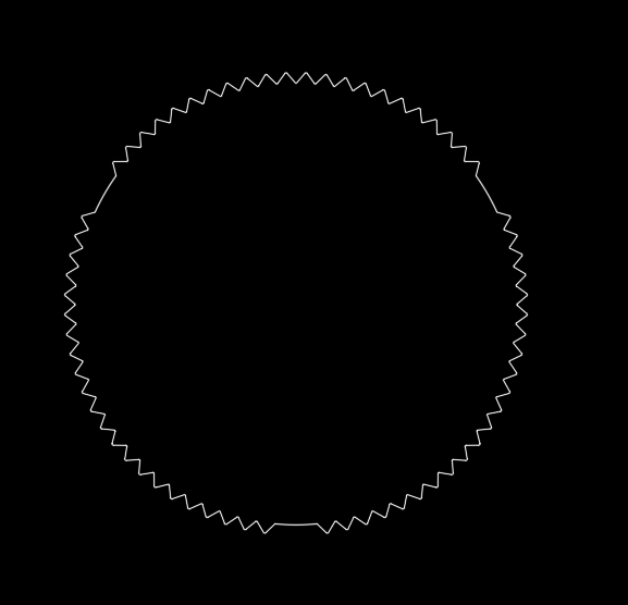

@GLAVCVS I’ve been testing your latest code. It’s truly impressive. I’m attaching an image of the most difficult area of the last drawing: it’s hard to find a spot where the centerline is not perfectly equidistant. And where it isn’t, it’s always below the tolerance — hats off to you. I’ve also been curious to try the code on embedded geometric figures. As you said, the code fails quite badly here. But when it does work, it returns results that are quite different from those of the @dexus or @GP_ codes, which are much simpler I wonder: why?
