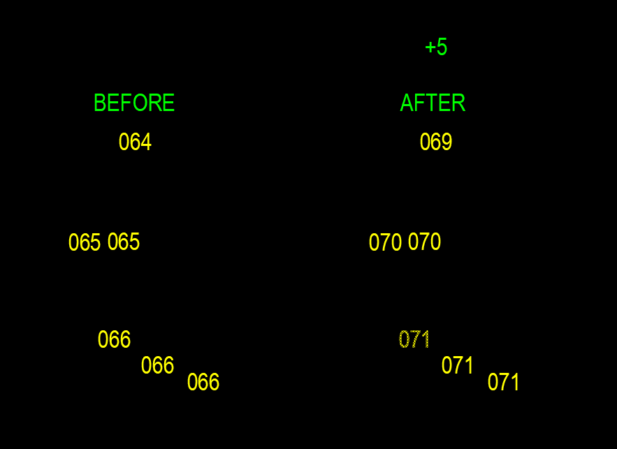

  2. hello: Now I find myself in another situation. I have an attdef group I would like to be able to make a selection in a window and that the numbering is increased or decreased by a desired amount. maintaining the numbering format with zeros examplse (001,020,999) example: any help you can provide, thanks. Drawing2.dwg

    Ok for now thanks, I thought it was much simpler. Thanks a lot
  11. SLW210
    nestedblock window
    As I have already mentioned, that LISP has too many issues. I trash canned all of my attempts, @pkenewell is correct, I had something else in there. I'll try to think about it. Yes, I had nil there. Every issue I tracked down, a new one came up. Just forget that LISP and start from scratch.

  22. SLW210
    TCOUNT for multileaders
    Works for me here as well.
  23. SLW210
    I placed a new LISP in my earlier post to just do a Sequential Find and Replace, see if that works for you. I am working on a bigger LISP with dialog box input and select the options, but that's going to be a while due to my workload.
  24. SLW210
    You still haven't provided the before and after drawing or the steps you want.
