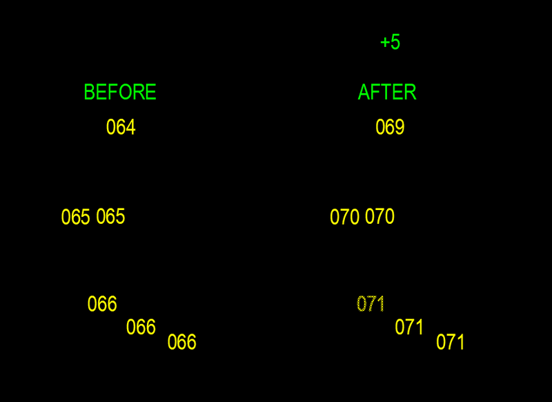

There is a routine that I use for texts and it helps me know what number is missing in a series of numbers.
A similar one would help me a lot but for "ATTDEF" because I receive drawings in which other people number pieces, sometimes with texts and sometimes with "ATTDEF"
So I need to do an audit to know the amount of "ATTDEF", which number is missing and how many times each tag is repeated. :)

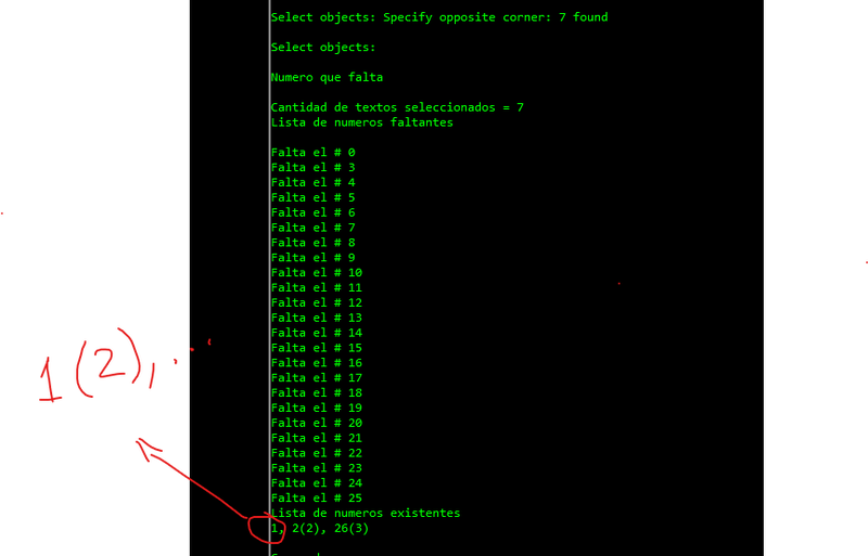

It's excellent, thank you
I just think there is a mistake
When the first number has more than one repetition, it is not counted.
Could it be possible to export a file xls with two columns of values, its tag and its quantity?
image.thumb.png.eb3e931b0f91c61282d5568562b6a103.pngimage.png.40b88713ce2aea4c0218939683dec6a1.png
;BACALADODEBILBADOO.noes

you can make the routine show the number of selected texts and the number of attributes,  please
;BACALADO DE BILBADOOO (PLUS)

sorry , I will try to explain myself again
the routine you created selects texts and attributes, that's excellent.
What I would like you to show is...
example:
color green texts
color yellow ATTDEF
That is, of the total number of selected objects, how many are texts and how many are ATTDEF ,
regardless of how many times its tags are repeated.
another example:
number of selected texts : 6
number of selected ATTDEF : 3
I needed Excel to account for them, but if all the amounts are shown here it is very helpful and Excel is not necessary.
thanks
hello:
Now I find myself in another situation.
I have an attdef group
I would like to be able to make a selection in a window
and that the numbering is increased or decreased by a desired amount.
maintaining the numbering format with zeros examplse (001,020,999)
example:
any help you can provide, thanks.
Drawing2.dwg
Load VT , start with VT (or C:VT)
Click on one of the attdef's , you get the main dialog
Click on setup (bottom right) and change difference to 5 , click on ok to return to main dialog
Finaly click on Renum and select all attdefs , enter, done...
VT uses grread in a constant loop so exit with escape, cancel or spacebar that will get you in quick menu and you can escape / Quit / cancel from there.
Not all buttons will work because some are company specific like revision but for now it should get you what you need.
VT.LSP
  • Like 2
  • Thanks 1
This post is like option 2 of this post. Is there an option 3 ? Will answer last question in other post. Suggest keep all in one post.
Give this a try does both requests.
