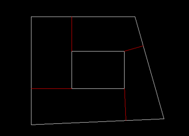

Drawing a house with just 10-key input.
BIGAL replied to Ataim's topic in AutoLISP, Visual LISP & DCL
Many years ago "Civilcad" software had that function, draw a shape and click on boundaries you could do things like set a side and slide along that side with updating offset to other sides as one option. So understand what you want but no solution, sorry. Not sure if it ended up in current software "Magnet". Note in the image the offset line to the angled line., it will always be the closest corner and changes automatically depending on the shape. Welcome to Cadtutor. Post a sample dwg with some examples of what your looking for, a before and after is best. - Today
