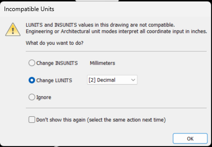

ColinPearson started following inputting imperial units
ColinPearson replied to mgervais's topic in AutoCAD 2D Drafting, Object Properties & Interface
The other thing that's great for Architectural Units is to remap the NumLock key to type the single quote ( ' ), then you can do all your input from the 10-key pad -
