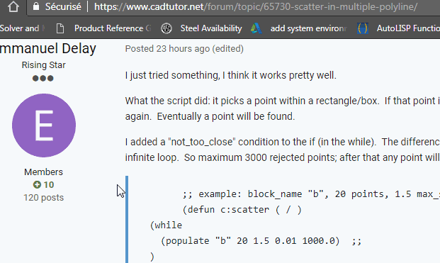

  2. Added Chars (question marks) after COPYING from CODE (I'm joining an animated gif to show the behavior, hoping it shows) That happened to me maybe 3-4 times so far. Trying to figure out why this code bombed on my side, I found out that the var "msp" wasn't defined (but the var "msp?" was). I was about to post about that and noticed that the the var in the code section was actually "msp", and not "msp?". (Having tried numerous time in the past to use "wisiwig" kind of things, I found out that too often we get our text messed due to hidden mismatched tags, so back then I just learned how tags worked and controled them manually, turning off for good wisiwig.) I thought that maybe some kind of html tags were responsible for the added question marks, I pasted in notepad (that I always use to remove all formatting from copied text when I need to remove formatting) and to my surprise it modified the police of the txt file after pasting in it. In vlide, it instead adds randomly "?" The weirdest part is that when I reload the page either "?" don't insert themselves in copied text, or get inserted randomly at (other) random positions as example below. (I just noticed on the gif that it added one inside the c:scatter function as well.) So I went back, reloaded the page, copied and pasted again and look. None in scatter and in the "msp" var name, and none at the end of that line but one has been added before the scatter command. Am I the only one having that issue?
