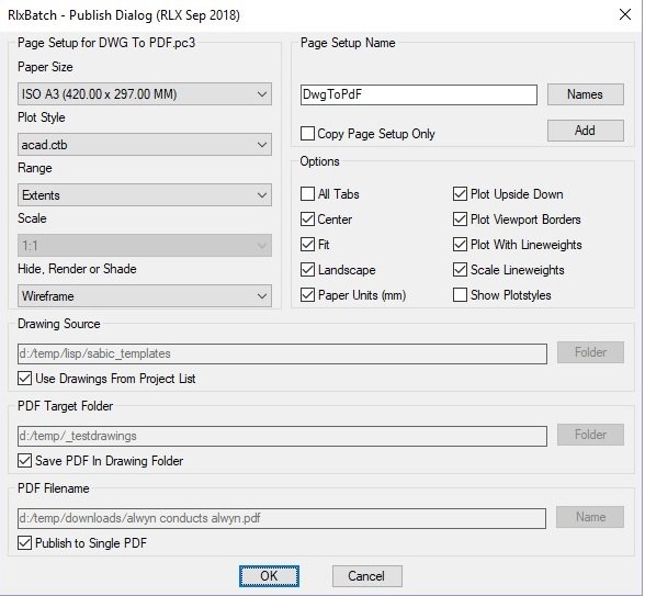

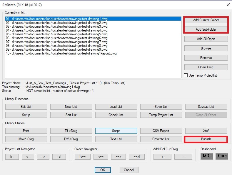

  1. This is for info only , just to show what I was working on before someone today had the nerve to say the W-word to me and dumped a new project on my desk. So some options are not implemented yet or maybe not stable. Haven't tested it on an other pc yet so this may not work. Put some test drawings in a folder , start app (c:rlxbatch) and add drawings to project list either by add current folder when one of the drawings is loaded or use add subfolder and save the list with a name. Goto to publish , do settings , either select copy setup only (or not) , select Publish to single PdF and Use Drawings From projectlist and hopefully someting good happens.... Will try to work on it later , but just to give an idea... RlxBatch.lsp
