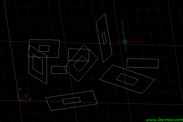

  3. Try the following for rectangles at any rotation & orientation: ;; Rectangle in Rectangle - Lee Mac ;; Constructs lines between the vertices of rectangles inside rectangles. (defun c:rr ( / a e i l m p r s v x ) (if (setq s (ssget '((0 . "LWPOLYLINE") (90 . 4) (-4 . "&=") (70 . 1)))) (progn (repeat (setq i (sslength s)) (setq i (1- i) e (entget (ssname s i)) v (mapcar 'cdr (vl-remove-if-not '(lambda ( x ) (= 10 (car x))) e)) a (angle (car v) (cadr v)) ) (if (and (equal (distance (car v) (cadr v)) (distance (caddr v) (cadddr v)) 1e-8) (equal (distance (cadr v) (caddr v)) (distance (car v) (cadddr v)) 1e-8) (equal (distance (car v) (caddr v)) (distance (cadr v) (cadddr v)) 1e-8) ) (progn (if (apply 'LM:clockwise-p (mapcar '(lambda ( a b ) a) v '(0 1 2))) (setq v (reverse v)) ) (setq m (list (list (cos a) (sin a)) (list (- (sin a)) (cos a))) r (mapcar '(lambda ( x ) (mxv m x)) v) p (apply 'mapcar (cons 'min r)) ) (while (not (equal p (car r) 1e-8)) (setq r (append (cdr r) (list (car r))) v (append (cdr v) (list (car v))) ) ) (setq l (cons (list r v (cdr (assoc 38 e)) (cdr (assoc 210 e))) l)) ) ) ) (setq l (vl-sort l '(lambda ( a b ) (< (caaar a) (caaar b))))) (while (setq x (car l)) (setq l (vl-remove-if (function (lambda ( y / n z ) (if (and (vl-every '<= (caar x) (caar y) (caddar y) (caddar x)) (equal (setq z (caddr x)) (caddr y) 1e-8) (equal (setq n (cadddr x)) (cadddr y) 1e-8) ) (mapcar (function (lambda ( a b ) (entmake (list '(000 . "LINE") (cons 010 (trans (append a (list z)) n 0)) (cons 011 (trans (append b (list z)) n 0)) ) ) ) ) (cadr x) (cadr y) ) ) ) ) (cdr l) ) ) ) ) ) (princ) ) ;; Clockwise-p - Lee Mac ;; Returns T if p1,p2,p3 are clockwise oriented (defun LM:clockwise-p ( p1 p2 p3 ) (< (* (- (car p2) (car p1)) (- (cadr p3) (cadr p1))) (* (- (cadr p2) (cadr p1)) (- (car p3) (car p1))) ) ) ;; Matrix x Vector - Vladimir Nesterovsky ;; Args: m - nxn matrix, v - vector in R^n (defun mxv ( m v ) (mapcar '(lambda ( r ) (apply '+ (mapcar '* r v))) m) ) (princ)
    1 point
