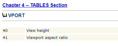

  4. @DavidGraham - does this help any? (Click on VPORT in left frame)
    1 point
