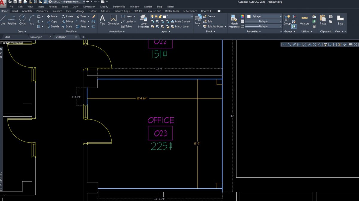

  3. So far looking good. Loving the new 'Quick Measure' command. More to come....
