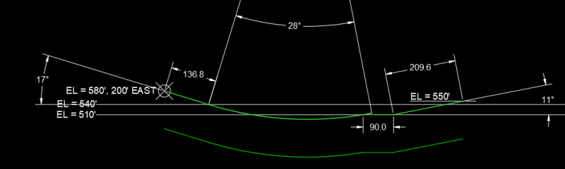

  5. WOW the degree of accuracy in those instructions is underwhelming is it 130' or 136.8121????' WIth an approximate total length of 794.6157' or there abouts. I would worry about the 0.0001 difference between total length shown in the properties palette of 794.6157 as opposed to adding up the shown dimensions 794.6156 but this is just an approximation and I may have miss read the instructions.
    1 point
  6. Here's my interpretation using AutoCAD. Note that the total length of the green curve is about 900'. The 700' you reference does not include the 11° exit slope. The center of the 1000' bend is located on a line perpendicular to the 17° line.
