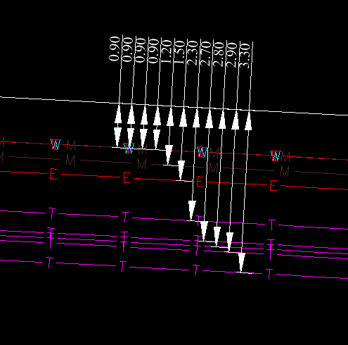

  4. Started to play with dims and the obvious is that a point number must be added, to what ever is picked. This is common for me a road set out plan. Yeah still not sure why ? Thinking more there is do object code out there so why bother with dims just do. pline1, len1 pline1, len2 pline1, len3 pline2, len1 pline2, len2
